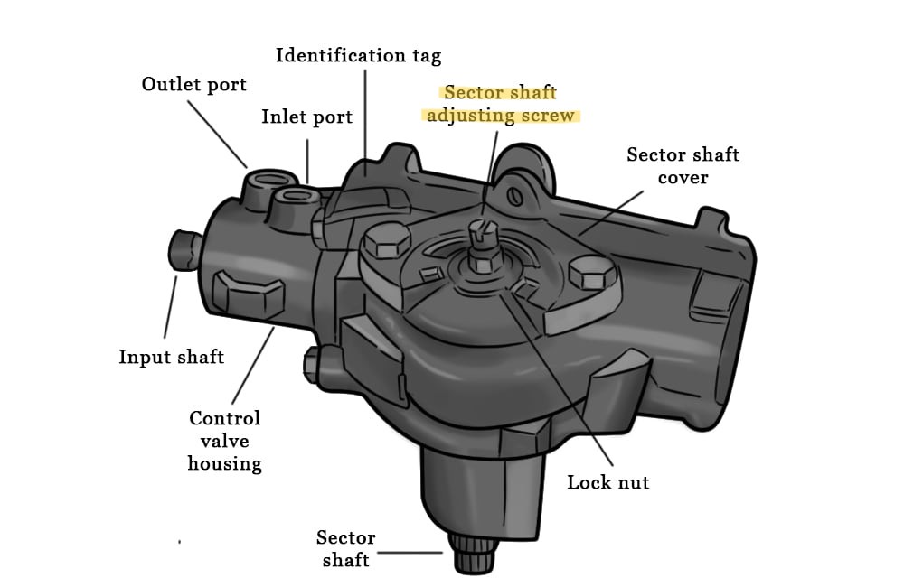

STEP 1: Locate the adjuster screw and jam nut on top of the steering box. This is labelled as the “Sector shaft adjusting screw below”.

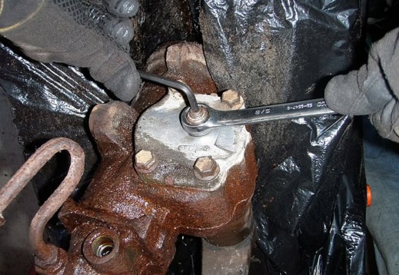

STEP 2: Loosen the jam nut several full turns to free the adjuster screw. This lock nut secures the adjustment in place and prevents it from turning during operation, so it must be backed off enough to allow the screw to move independently.
STEP 3: Use an Allen key to turn the adjuster screw clockwise until it lightly bottoms out. This seats the internal gear fully without applying pressure. Do not torque or force it—stop as soon as it makes contact!
STEP 4: Back the adjuster screw off (⅛–¼ turn max) from the seated position. This slight back-off relieves preload on the internal gear while keeping the adjustment tight and responsive.
STEP 5: Hold the adjuster screw steady with the Allen key to prevent it from turning, then tighten the jam nut securely against the housing. This locks the adjustment in place and preserves the setting you just established.
