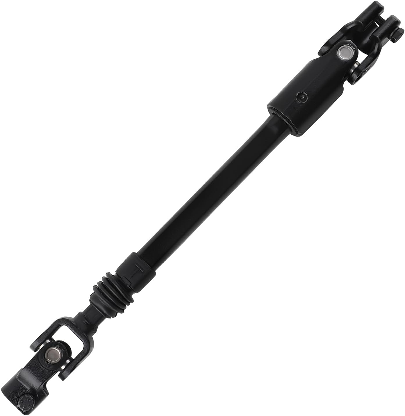

Swapped out the factory rag joint for a solid shaft. Big difference.
Steering is way tighter now. No more slop or delay β€” truck actually responds when you turn the wheel.
:link: What I Used
Jeep Cherokee 1984-1994 Steering Shaft
:brain: What It Fixes
Factory rag joint wears out and causes play.
This replaces it with a solid connection.
:warning: Fitment
Works for:
  • 88–94 GMT400
95–98:
  • Not direct fit
  • Use proper shafts like:
    • Cunningham Machine
    • Borgeson
:wrench: Install
2 bolts. Swap it out. ~30 mins.
:warning: Notes
  • Slightly more steering feedback (normal)
  • Make sure bolts are tight + use threadlocker
:brick: Bottom Line
Cheap upgrade that actually works.
If your steering feels loose, this is worth doing.
