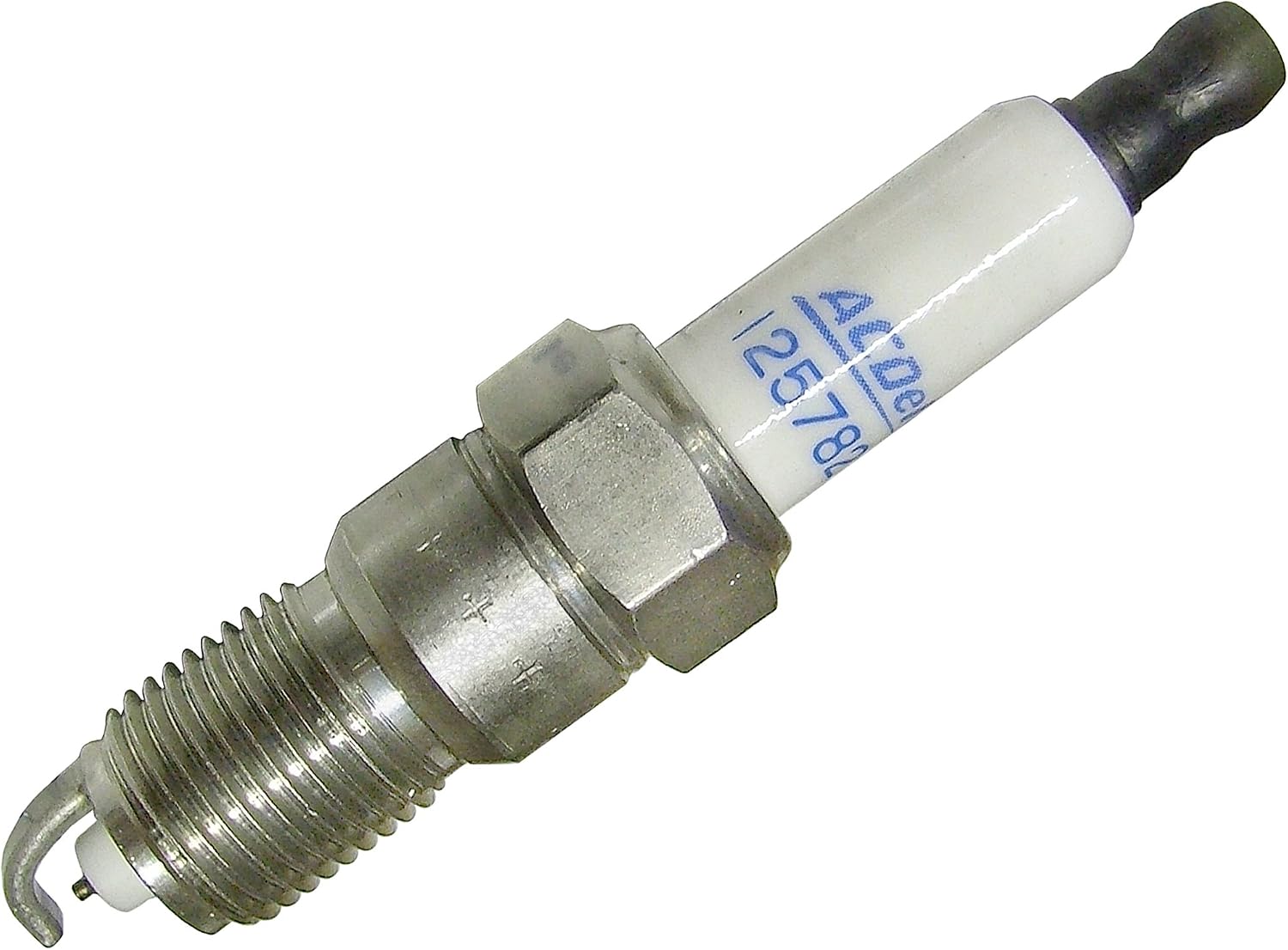

Plugs: ACDelco 41-983, gapped at .045"
I’m running ACDelco Iridium 41-983s gapped to .045". These plugs often come pre-gapped from the factory around .060", which is too wide for an older ignition system. Check the gap before you install — don’t assume it’s correct out of the box. I noticed a big difference in going from .060" to .045" - the truck seemed to start better, idle better, and the hot idle lowered as well!

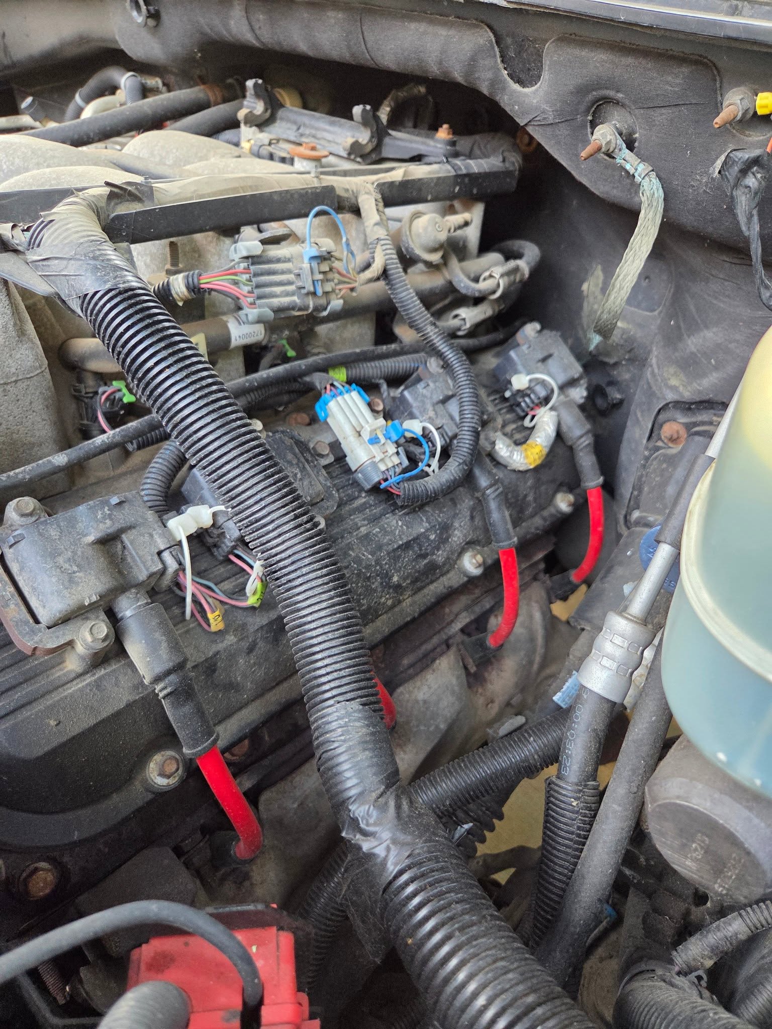

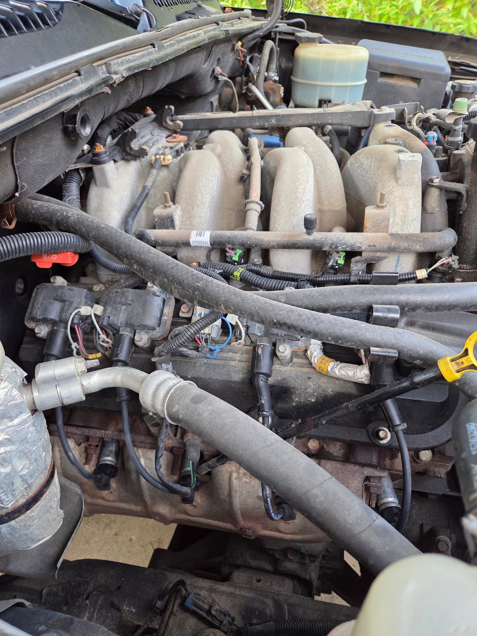

Last plug change this spring I broke two 8.1L wires while doing plugs. Unfortunately I needed the truck running that weekend to haul a truck on a trailer, and got caught with 2 broken wires on a Friday afternoon. I called around, and did NOT find any 8.1L wires locally. I even checked Amazon, and found wires to be 3 days away. I didn’t have any other option, and so I decided to do some investigating and found out that LS wires will fit.

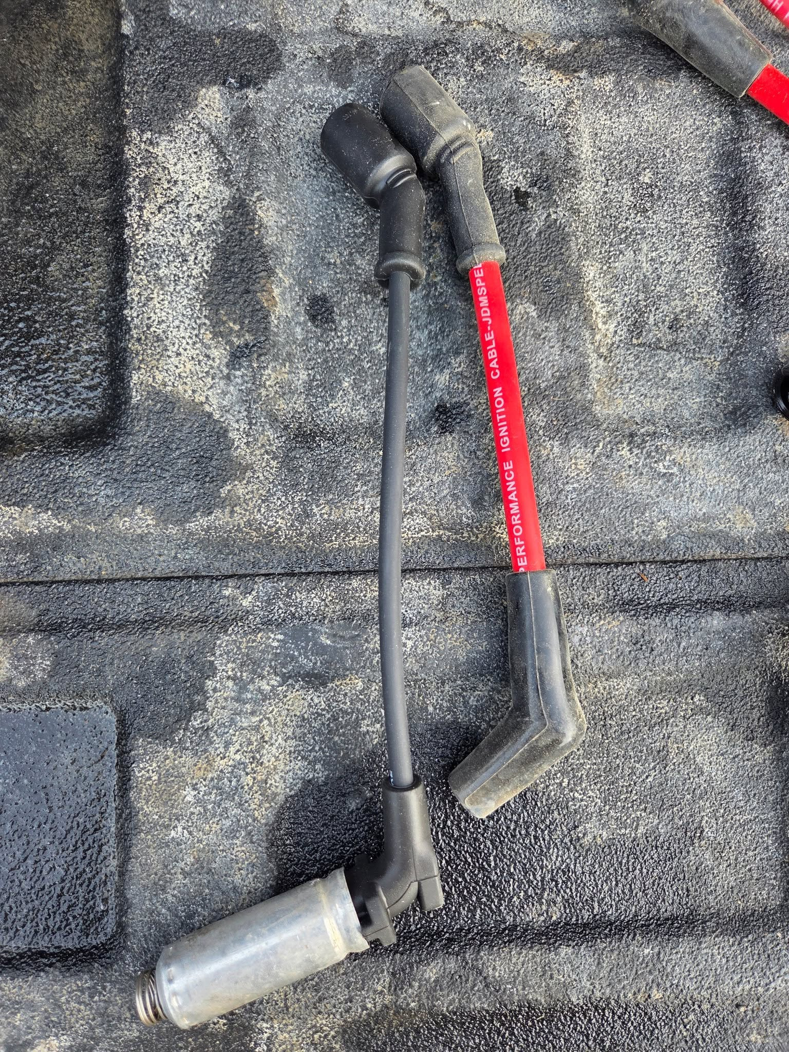

I had a set kicking around from another build; just cheap red LS wires off Amazon.
I ran the set for several heat cycles on a short tow trip without issue. A few things to know:
  • LS wires are about 2 inches shorter than the 8.1L wires — just enough to reach, but there’s less slack. Not ideal, but if you are in a pinch this could easily fix your rig. In my case it meant that my planned tow trip could still happen!
  • The ones I had were red (see pic posted below) — easy to find, widely available and cheap. You can get them here.
  • A heat shield sleeve would help since routing near the manifolds is tighter with the shorter length, but in a pinch the wires worked for me. If I had to do a long trip, I would definitely add ceramic heat shields near the manifolds.
This isn’t a permanent solution, but if you’re in a bind on a weekend and need the truck running, grab a set of LS wires and you’ll be fine until the correct wires arrive. LS wires are readily stocked everywhere - 8.1 ones are not!!
