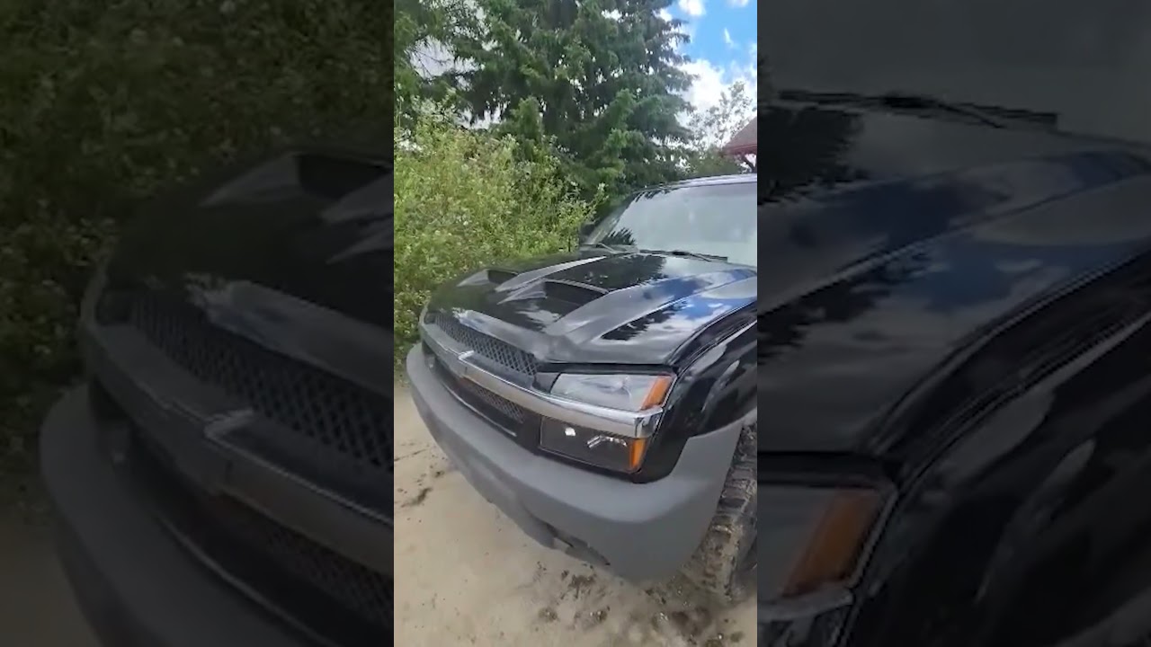

My 2002 Avalanche 2500 8.1L Vortec had been giving me consistent startup valvetrain chatter every cold start while running 5W-30 full synthetic. Top-end rattle for the first several seconds, then it would quiet down once oil pressure built. The truck had sat for about two weeks — there’s no oil left in the top end after that. It drains back down to the pan.
One oil change later — switched to Shell Rotella T4 15W-40 — and it was gone. Next cold start, quiet. Every start since, quiet.
