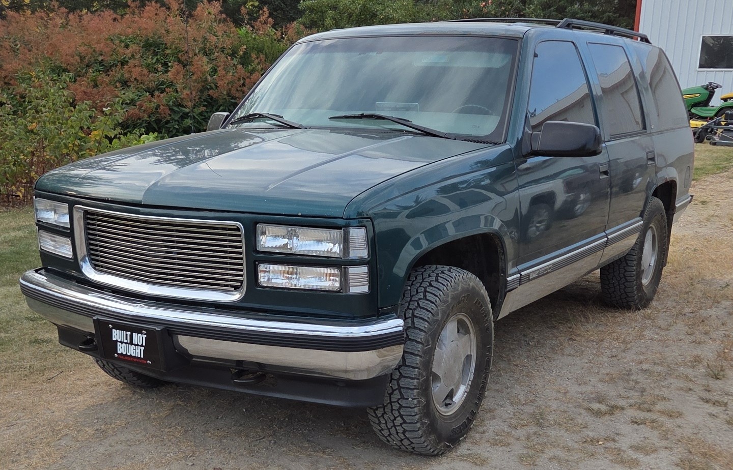

OBS Sawblade Wheels (96–98) — Specs + How to Restore Them Properly
If you’ve got a GMT400, you already know these wheels.
The 5-spoke “sawblades” GM ran in the late OBS years. No official name, just what everyone calls them.
Still one of the best factory wheels GM made.
Dropping all the key info and a proper way to bring a set back.
Specs (for anyone hunting a set)
  • 16×7
  • 6×5.5 bolt pattern
  • +31mm offset
Part numbers (common):
  • 12360532/12351802/15530906/15650049
Fitment:
  • C1500 / K1500 (92–99)
  • Tahoe / Suburban / Yukon (92–99)
Finish:
  • Machined face
  • Charcoal or black pockets
  • Clearcoated from factory
Caps:
Lugs:
  • M14×1.5 conical
Why people still want them
  • Clean OEM look
  • Harder to find now. If searching, check this thread.
  • Fit OBS trucks perfectly
  • Way better than most aftermarket options
