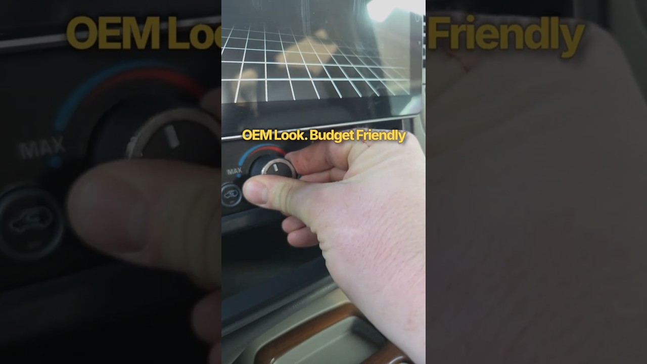

Video Demonstration
Here is a quick video showing the finished Express/Savana HVAC knob swap:
If the player above doesn’t load, watch it here: OBS Chevy HVAC Knob Upgrade (YouTube Short)

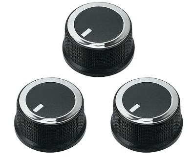

Best fit (OEM): GM 84141127 (superseded by 84793085), found in just about any 2008+ Express or Savana cargo van at junkyards or on eBay.

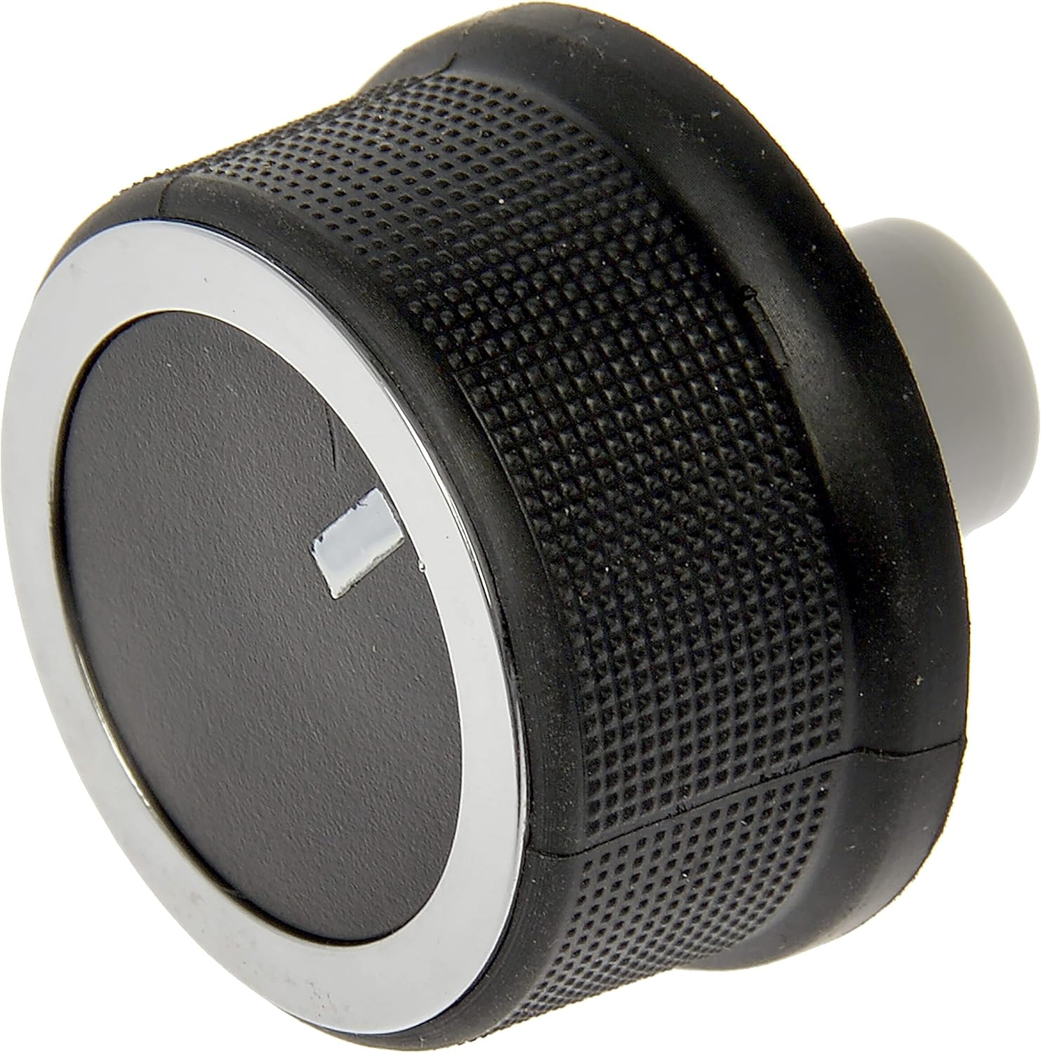

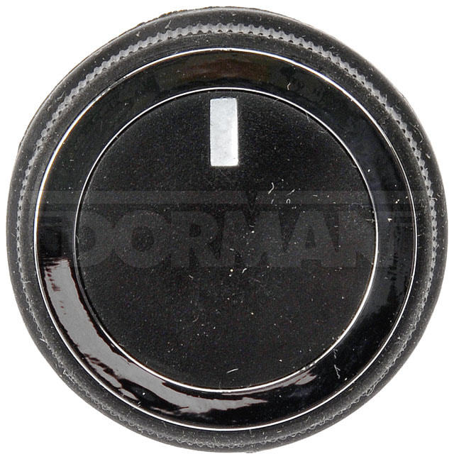

Chrome replacement: Dorman 76834 — readily available on Amazon or at your local parts store. This is the chrome option.
Black replacement: Dorman 76852 — same knob in standard black if chrome isn’t your thing.
Avoid: the generic Amazon knockoff knobs. They review well, but they’re missing the OBS knob stop and will over-rotate past the control’s max on the shaft. That single point is enough reason to stay away.

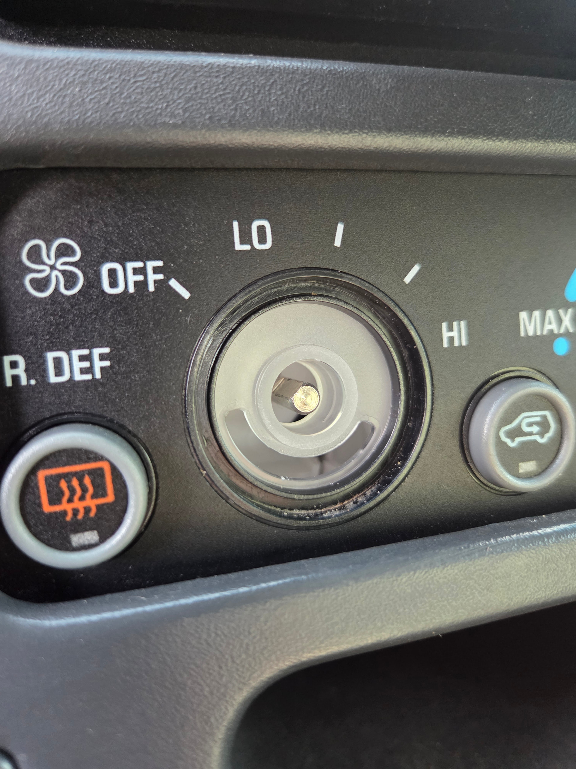

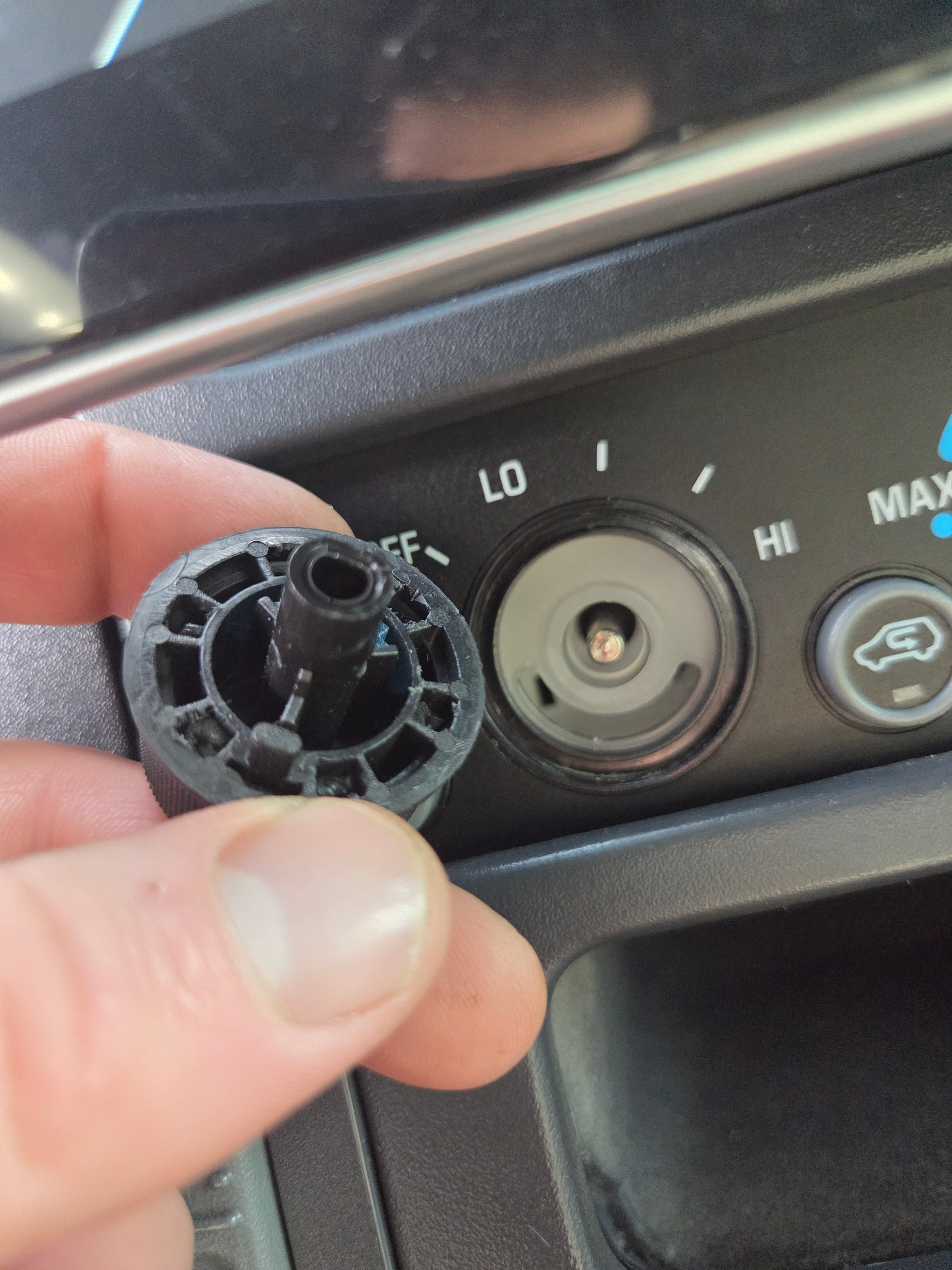

Here is the slot the HVAC knob stop drops into to prevent overtravel. Both the OEM and Dorman knobs have the knob stop — the Amazon ones do not.
So which knobs should you buy? For most owners the Dorman 76834 chrome knobs are the easy pick.

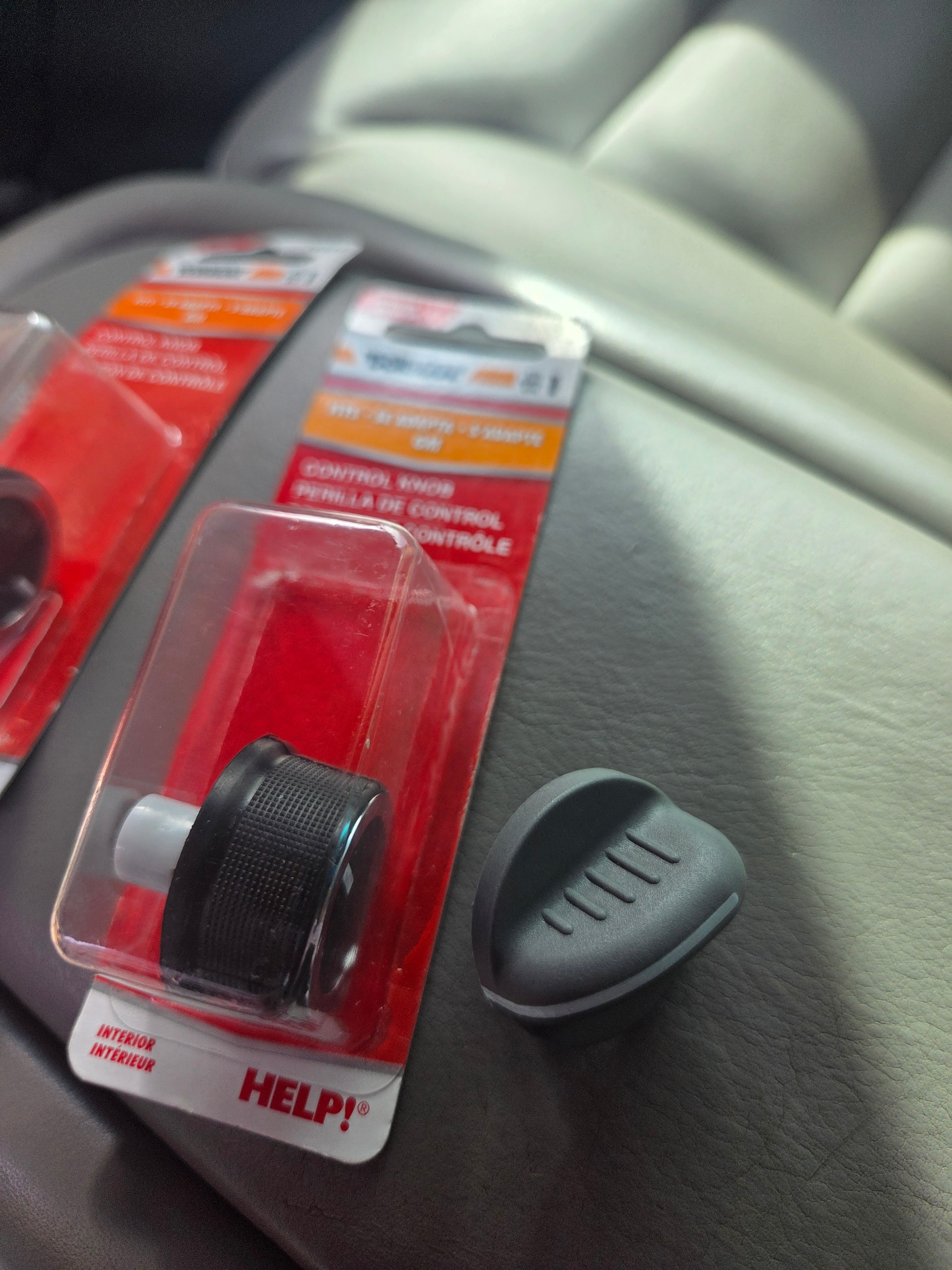

Here is the Dorman knob next to the factory knob.

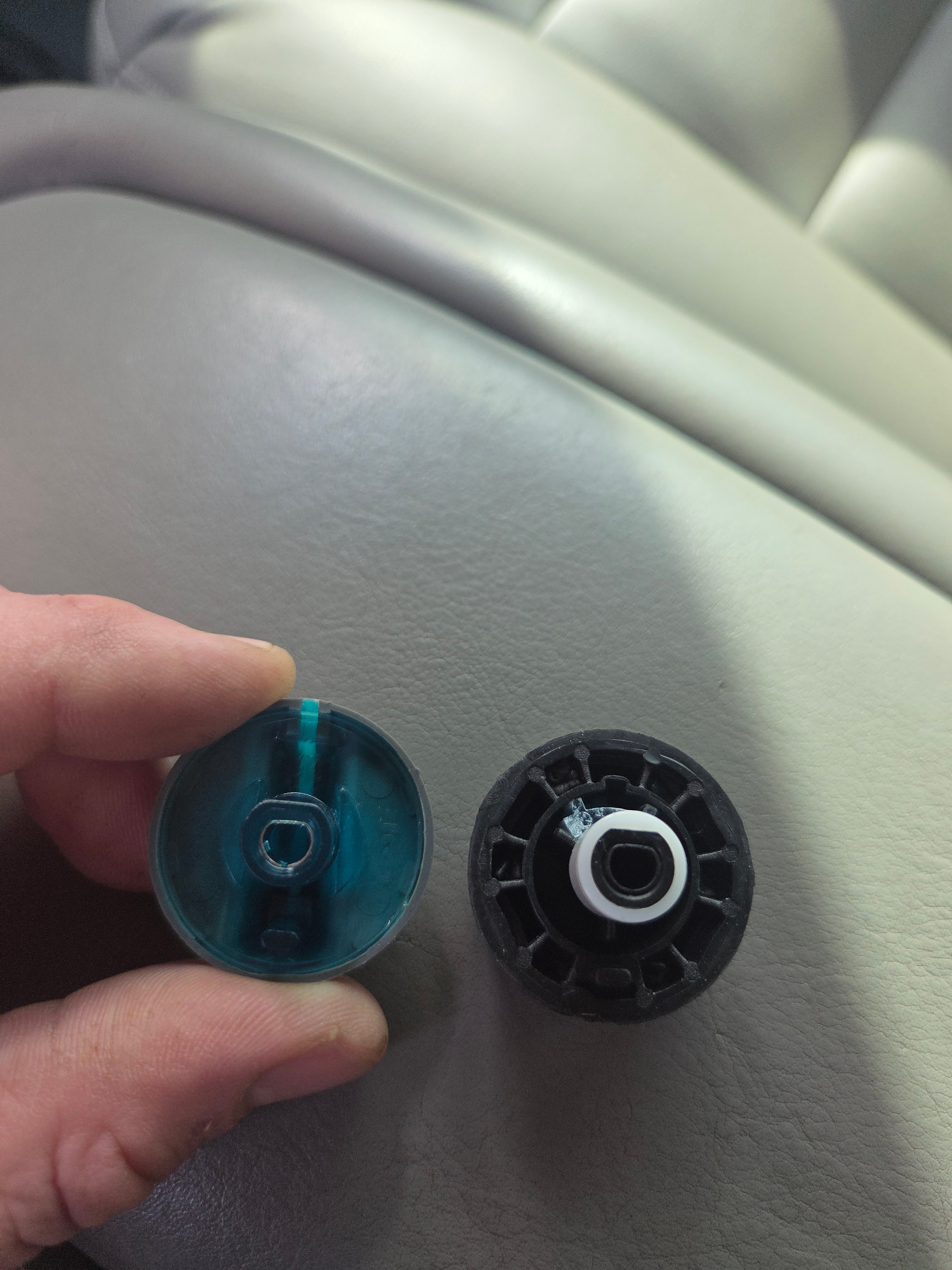

Required Prep: Pull the White Sleeve

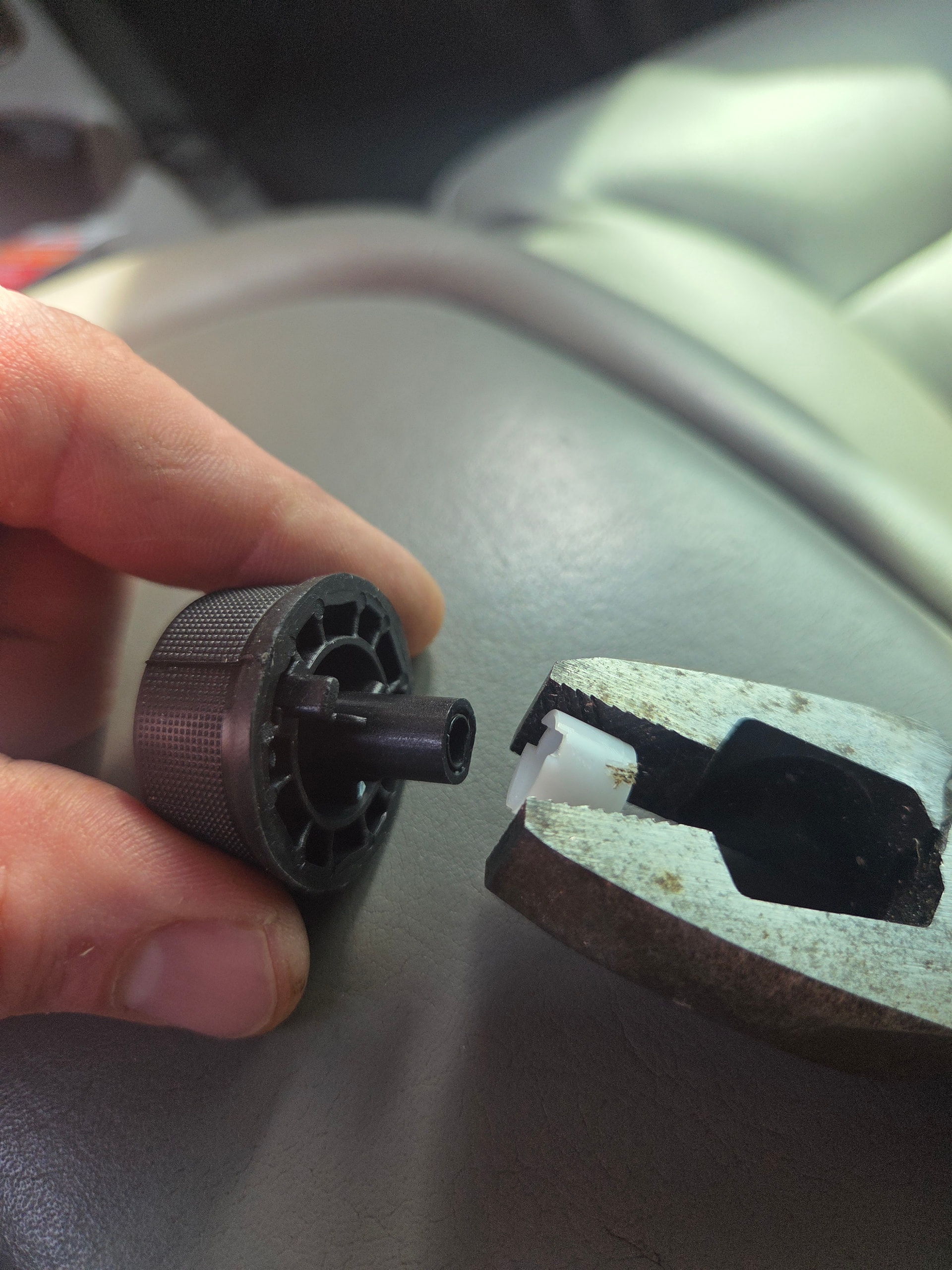

Must-do step: whatever knob you buy, pull the white plastic sleeve/ring/spacer off the back of each new knob before installation. The new knobs need to be black plastic only.
I used pliers to pull the white sleeve off. This shot also gives a good look at the Dorman overtravel knob stop (the Amazon knobs do not have this).

- Line up the flats, push the knob on, and rotate through all positions. If it binds, pull it back off slightly and try again. Don’t be afraid to use some force — most of the effort is getting the knob stop to seat inside the overtravel cutout, which is why both the knob and the control need to meet in the middle.

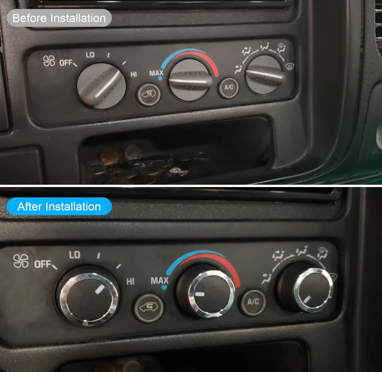

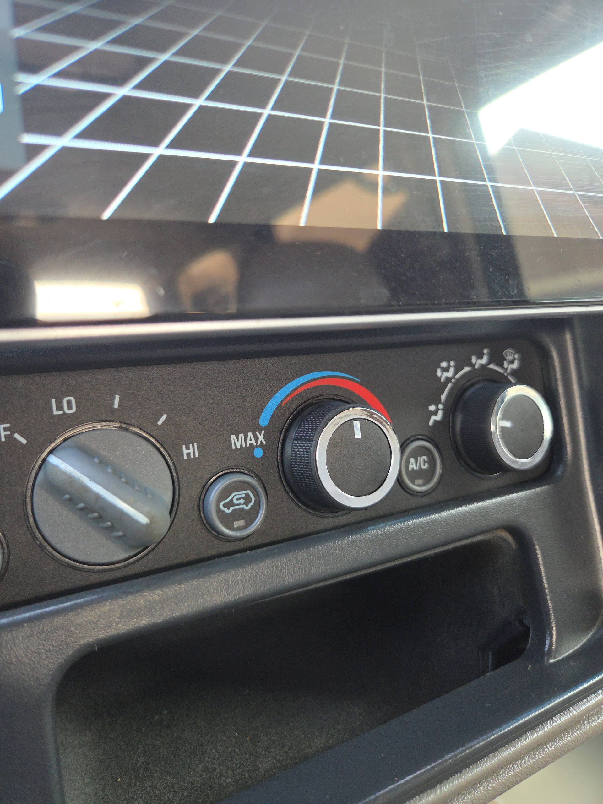

Before and After
Overall it’s a simple install. Here’s the difference between the stock knobs and the new knobs.

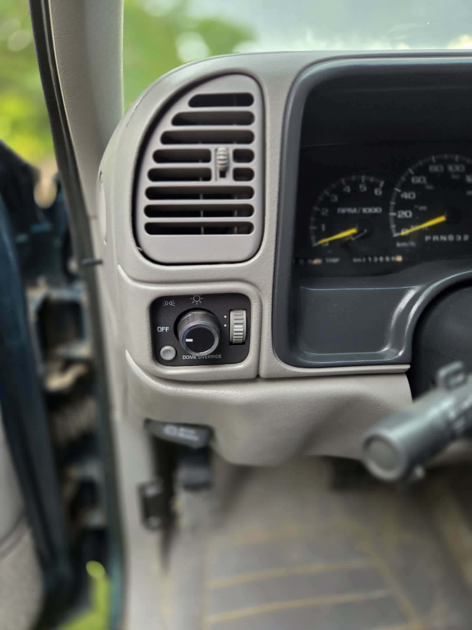

What About the Headlight Knob?
If you’re swapping the HVAC knobs, the headlight knob is the next one everyone asks about. Heads up: it is not a direct fit like the HVAC knobs.
Some people cut the shaft and modify the knob. Others glue the new knob onto the old shaft and call it good. Either way it takes modification, so test fit before you cut anything. I covered the full workaround with measurements here: OBS Headlight Knob Swap Using Chevy Express and GMC Savana Knobs.
