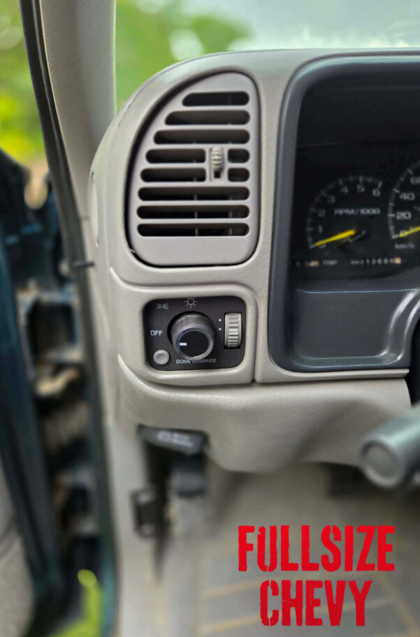

I finally got around to finishing up the Express Van headlight switch on the OBS. I used the Dorman 76834 knob, which is readily found on Amazon or at your local parts store. I went with the Chrome option to match the HVAC knobs.

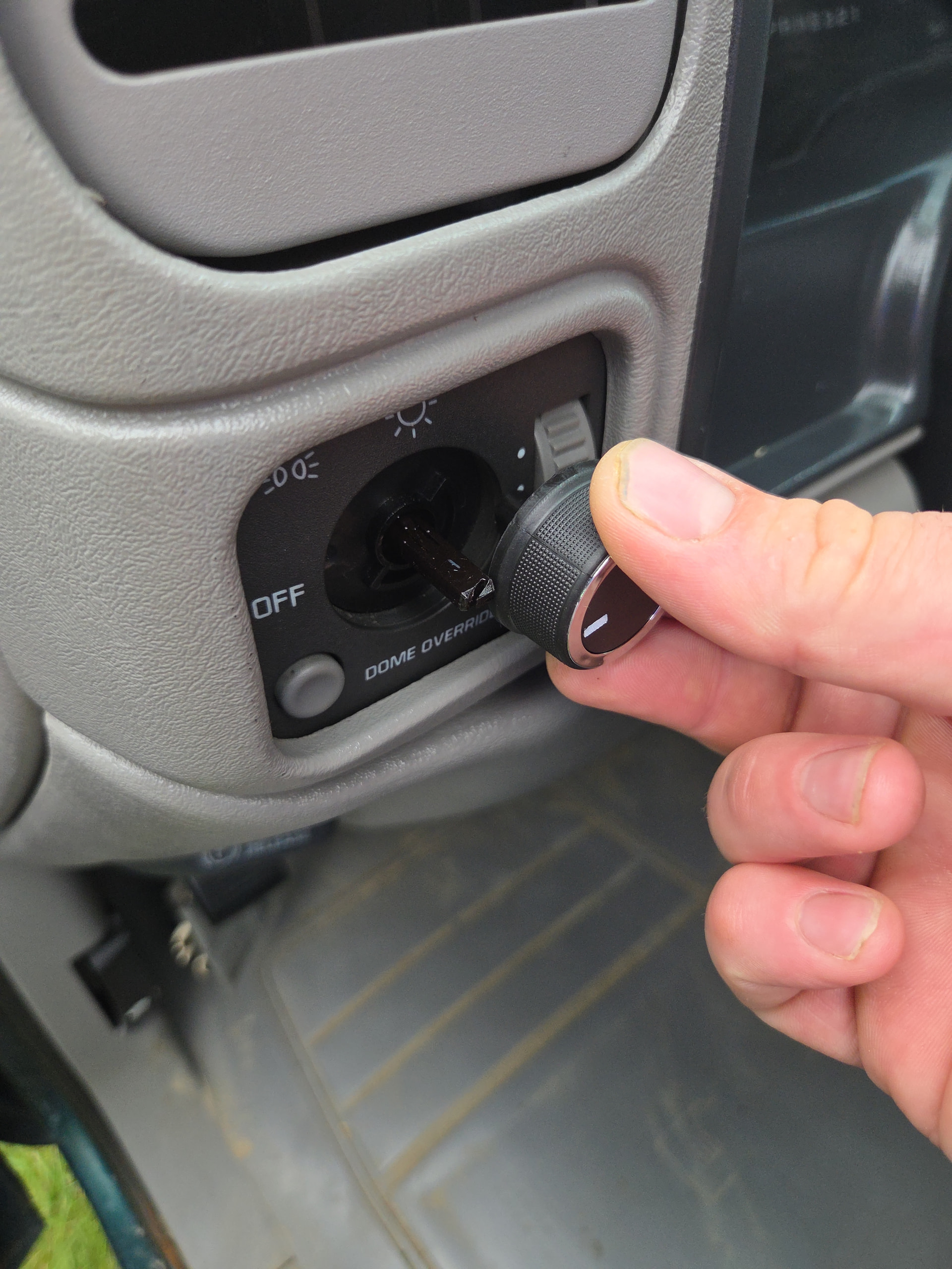

It would be easiest to do this swap with the headlight switch removed, but you can in fact do it with the switch still installed in the truck. You’ll have to brace the headlight switch and bezel if you choose to do the swap with the switch still installed in the truck (like I did).
I used Linesman’s pliers to remove the old OEM knob while bracing the switch and bezel. Once the old knob is off, you’ll notice that the OBS headlight switch shaft is too long for the new Express van knob and has to be cut down. I chose to modify the shaft and cut down the knob as well. If you want the knob to sit as close to flush in the circular cutout, you will end up cutting the shaft and knob so that only 3/8" of material is left on both the headlight switch shaft and the knob. Go slow when cutting, and test fit often.

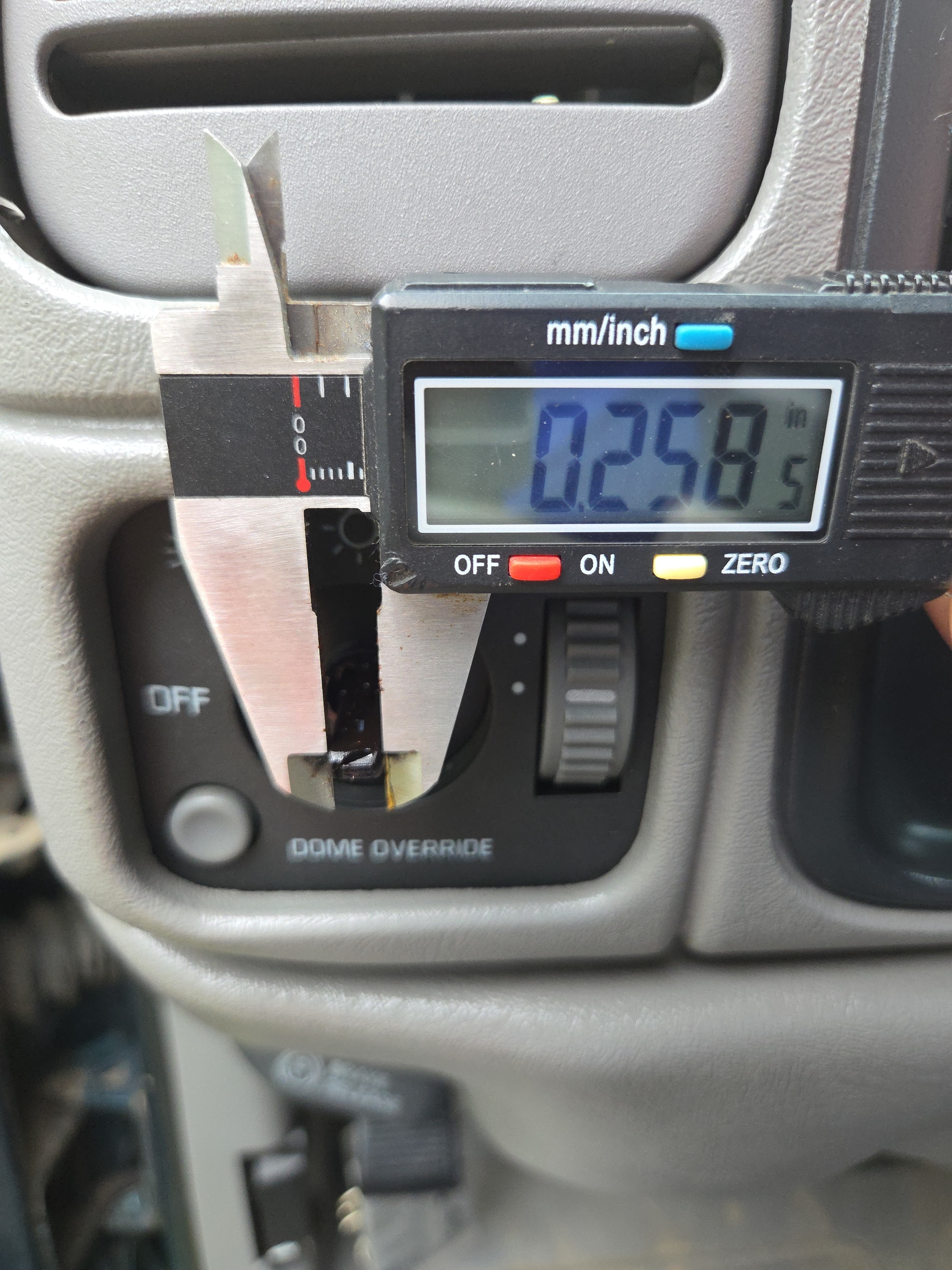

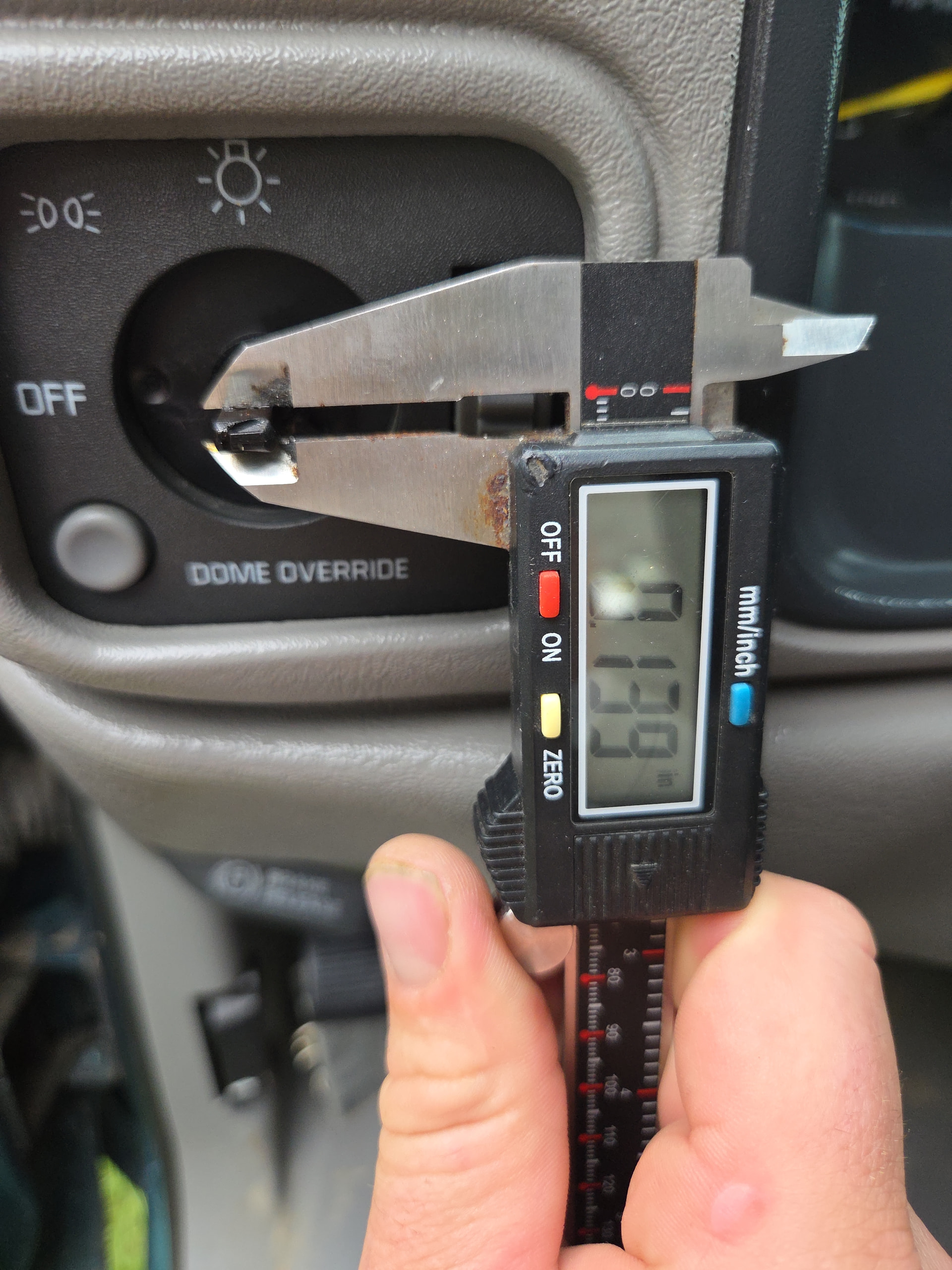

I took measurements of the shaft using a caliper and came up with .258" width. This means you’ll have to cut the sides out of the knob, so that the OBS shaft fits inside of the new knob.

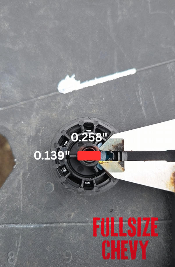

I came up with 0.139" height. This is the approximate measurement of how much height to cut out of the shaft.

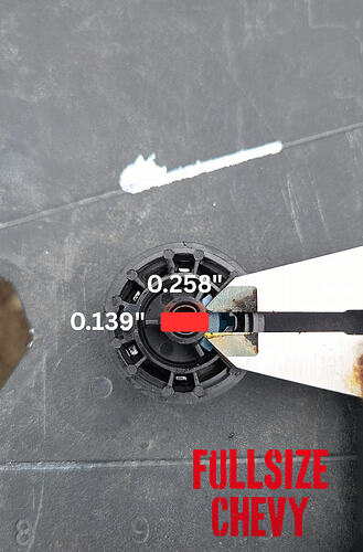

You’ll then want to transpose these measurements onto the headlight knob, and mark out the areas to be cut. To fit the OBS Headlight shaft onto the knob, the 0.139" height has to be measured, marked, and carefully cut out of the knob. The 0.258" width effectively means you’ll have to cut the sides out of the knob as well - but don’t worry, with clean cuts and a strong epoxy the knob will be rock solid on the switch. Below is an image of the measurements of the cuts.

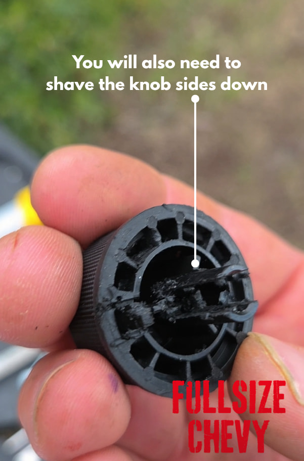

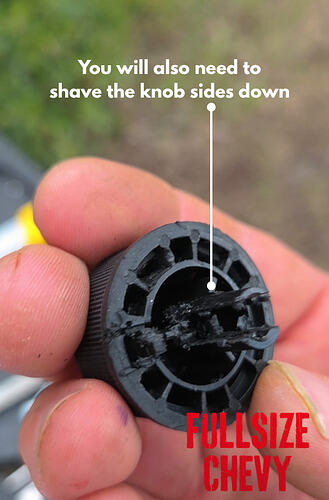

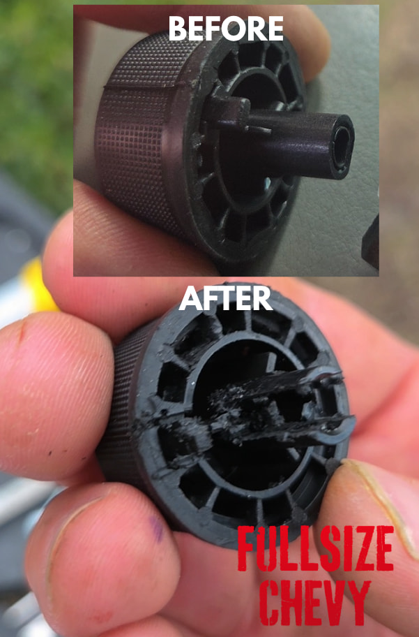

You’ll also need to “shave” the knob sides flush, so that the sides fit inside of the headlight switch.
Here is a clear comparison of what you’ll start and end up with. Once again, be careful when cutting, and test fit often. I found it helpful to go slow with the cutting. The knobs themselves are cheap, but the headlight switch is not.
