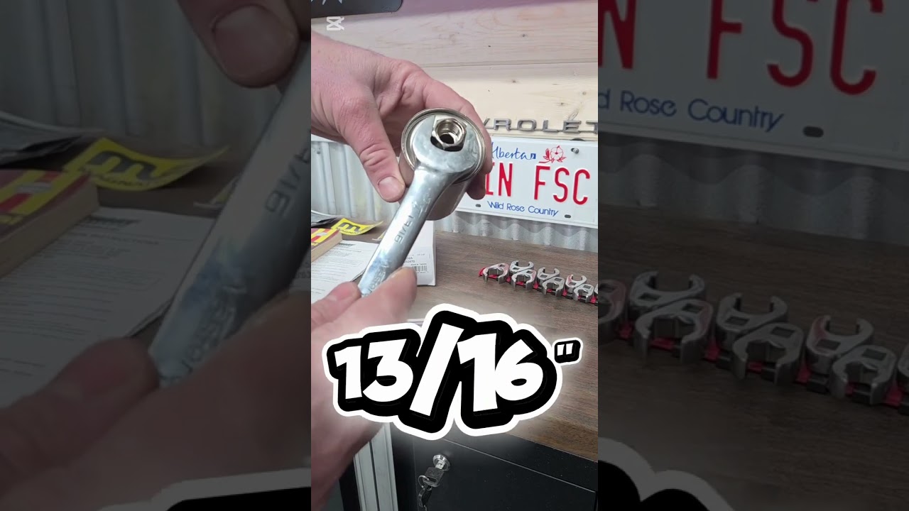

3. Replace the fuel filter
Located under the driver-side frame rail.
• 13/16" wrench for the filter body
• 5/8" wrench for the fuel lines
