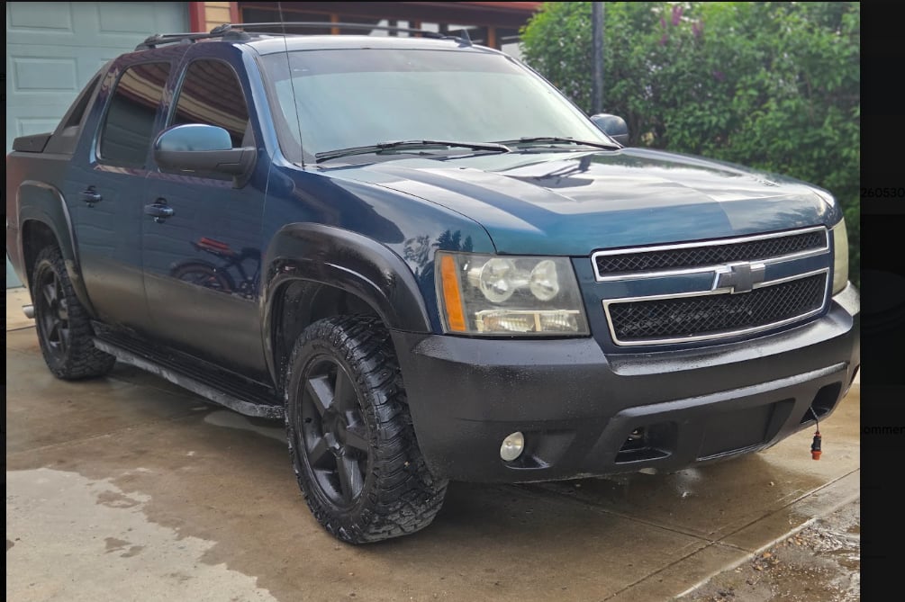

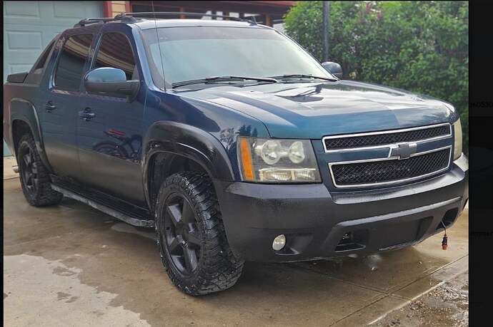

Yesterday for me was a cheap Cerakote Ceramic job on my Bermuda Blue LTZ Beater.

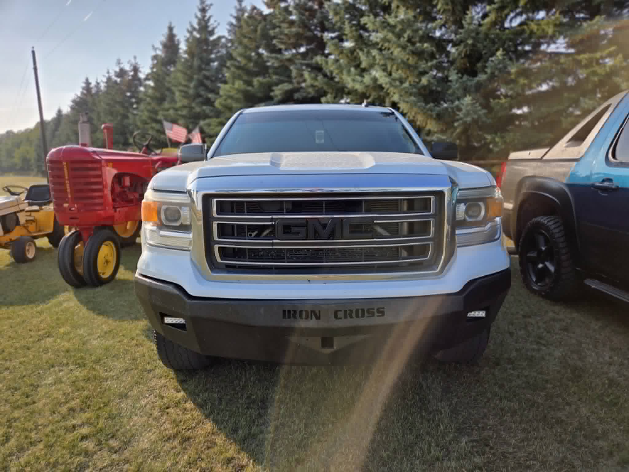

I’m repainting the bumper on my K2XX today.
No video; but it was horrendous. I have the Iron Cross slimline bumper and the paint on it from Iron Cross was terrible. It got sanded down/wire wheeled yesterday, and today it got Raptor lined with 2 coats of Black, followed up by 2K Clear an hour later. Hoping it lasts, will post photos tomorrow.

I ended up refinishing the front bumper with Raptor Liner, hope it lasts this time. I didn’t catch it on video as it was a bit hectic last week, but it was pretty straight forward.
This is the Iron Cross “Slimline” bumper on my 1500 K2XX. Paint quality was terrible from Iron Cross. After 2 Used sanding discs on a grinder, and a bit of blasting using my sandblaster for the backside. Did 3 coats of self etching metal primer, followed up by 2 coats of Black Raptor Liner and 2K Clear 1 hour after spraying the Raptor Liner.
