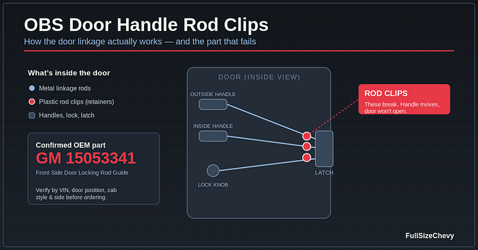

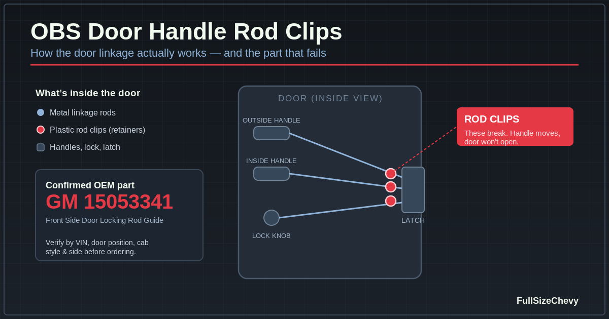

If your OBS door handle flops when you pull it but the door won’t open, or your lock knob is rattling loose inside the door, it’s almost never the latch. It’s a broken door handle rod clip — the little plastic retainer that holds the metal linkage rods onto the handle, lock, and latch. They get brittle with age and let go, and then the handle moves but nothing it’s connected to moves with it.
We put together a full write-up on the part numbers, including the one confirmed straight off a GM Genuine package: 15053341 (Guide, Front Side Door Locking Rod). Full article here:

The catch: OBS/GMT400 didn’t use one universal clip. Front vs rear door, 2-door vs 4-door, interior vs exterior handle, lock rod vs latch rod — they can all be different shapes and rod sizes. A number that’s dead-on for a driver’s front door on a '96 K1500 might be wrong for a rear door on a '97 Suburban. Verify by VIN, door position, cab style, and side before you order. Cheapest way to be sure: pull the panel, photograph the broken clip on the rod, and match by shape + rod diameter, or grab a Dorman/Shark assortment and fit by hand.
