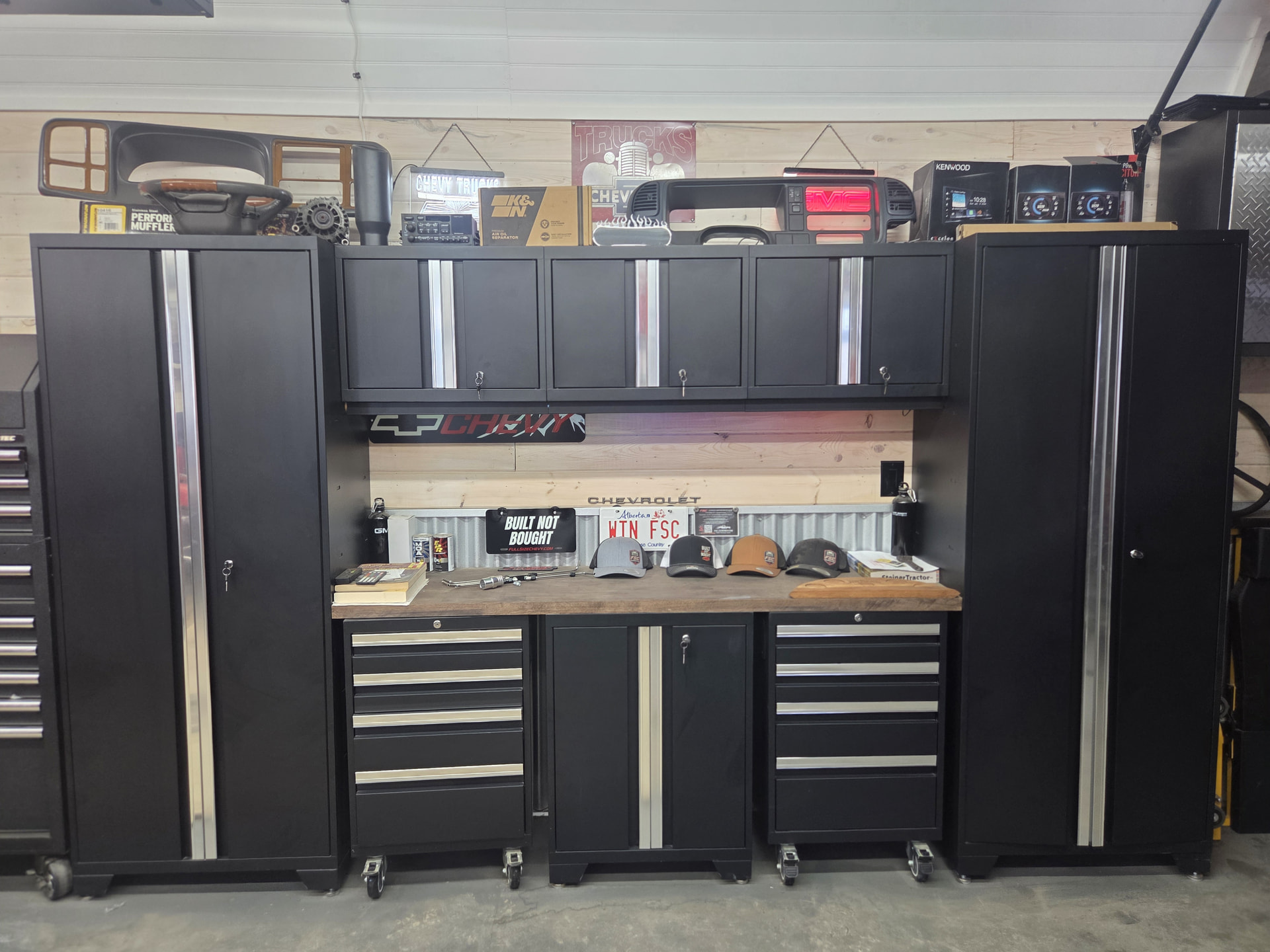

Weakest part of the whole package. The original bamboo top was thin and shallow and did not feel like it belonged with the rest of the set. I replaced it with a six-foot piece of butcher block about 1½ inches thick, ripped down to fit the cabinet depth. The difference is night and day, and it is something I can actually work on. Budget for that up front.
Installation

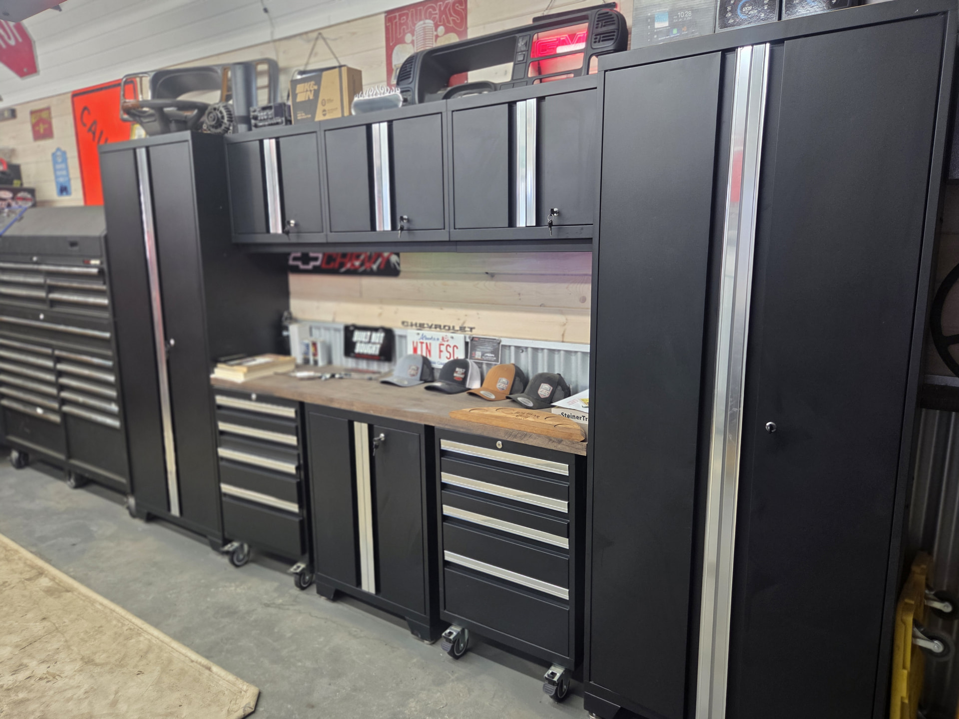

Not hard, just slow. Getting everything level, straight and properly spaced takes real time. I started at the toolbox end, got the first tall cabinet level and lagged into the wall, then used it as the reference for everything else. Lowers next, two of mine on casters and the centre one on adjustable feet. Uppers last.
The uppers were the sketchy part doing it alone. Get a second person for those. There are plenty of mounting holes, so hitting the wood framing behind my metal shop walls was easy. Three lag bolts per tall cabinet. Look at how your wall is built first, because the supplied hardware may not be long enough.
