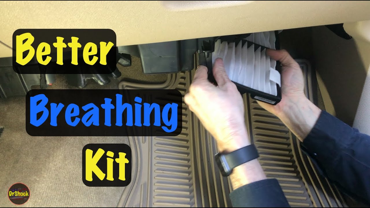

Installation Overview
The HVAC housing already has a factory-marked outline showing where the filter belongs.
  1. Remove the passenger-side lower dash panel.
  2. Locate the HVAC box behind the glovebox area.
  3. Find the rectangular molded outline in the plastic housing.
  4. Carefully cut along the outline using a utility knife or rotary tool.
  5. Vacuum debris from inside the heater box.
  6. Slide the cabin air filter into the slot.
  7. Install the retrofit access cover.
  8. Reinstall interior panels.
The filter slides into factory alignment grooves, so positioning is straightforward.
