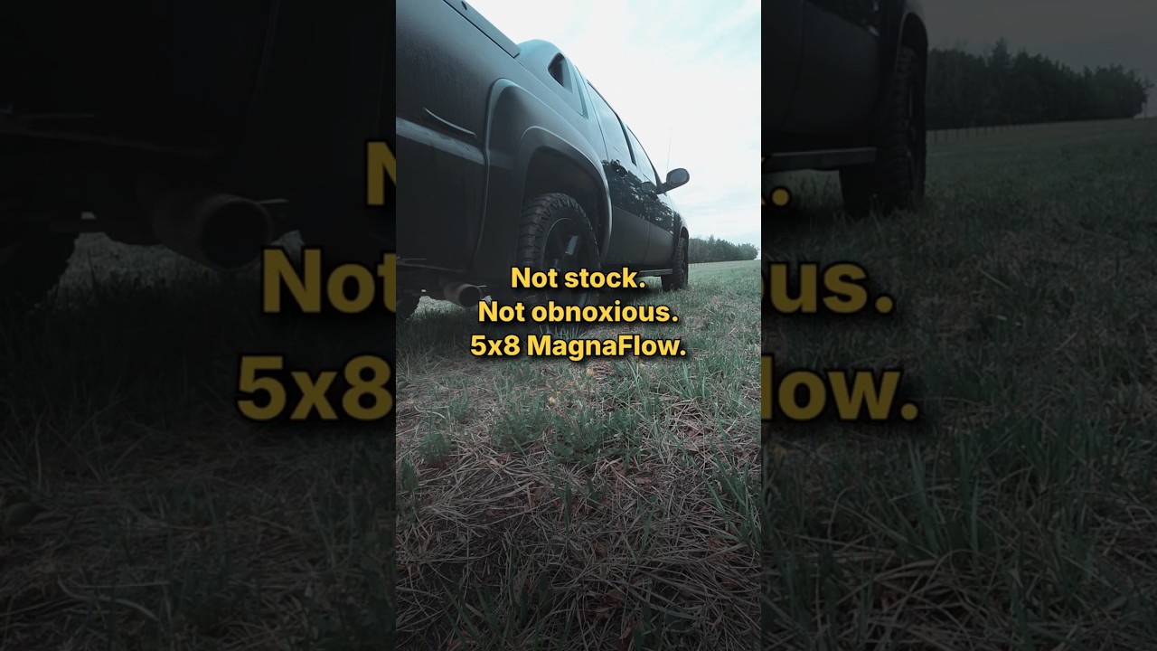

GMT900 5.3 Exhaust Setups — MagnaFlow 5x8 14" Case on a 2007 Avalanche
This is the exhaust setup on my 2007 Avalanche 5.3L Vortec (GMT900). I posted a quick sound clip so you can hear what a single MagnaFlow 5x8 14-inch muffler actually sounds like behind stock manifolds and gutted cats — no studio mic, just the truck running.
Clip here:
The setup
Item Setup
Truck 2007 Chevy Avalanche
Engine 5.3L Vortec
Manifolds Stock
Cats Gutted
O2 Downstream non-foulers only
Muffler MagnaFlow 12219 (5x8 oval)
Body length 14-inch body / 20-inch overall
Inlet/outlet 3-inch center/center
Factory pipe ~2.75-inch, adapted to 3-inch
Tip 4-inch rolled rear tip
How it sounds
Louder than stock and deeper, but still controlled. The 14-inch 5x8 body keeps it from getting loud and droney, the gutted cats add the depth, and the stock manifolds keep the tone from going raspy. Daily-driver friendly — not obnoxious at cruise or sitting in a parking lot.
Want it louder?
Quick comparison if you are picking a muffler:
  • 5x8 oval — most controlled, best daily-driver tone (what’s on my truck)
  • 4x9 oval — louder middle ground, still muffled
  • 4-inch round / glasspack-style — loudest and sharpest, more cold-start bark, most likely to drone
Downstream O2 note
The non-foulers are for the downstream/post-cat O2 sensors only. Do not put them on the upstream sensors — the PCM uses those for fueling. (And yes — gutted cats and O2 mods may not be road-legal in your area, so check local laws before copying this.)
