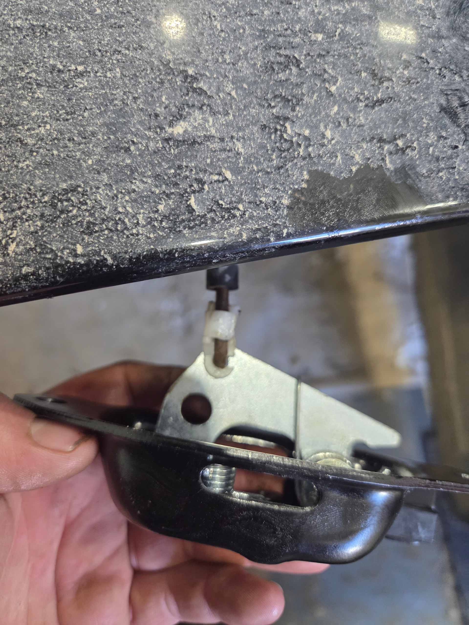

The hardest part of the job is removing the rods from the latches. The rods have to be pried out of the tailgate latches by means of a screwdriver, or needle nose pliers. I found it easiest to pry the rods out from the handle side using the clips on the tailgate handle. Once the rods are disconnected from the handle side, you can pull the tailgate latches cleanly out.

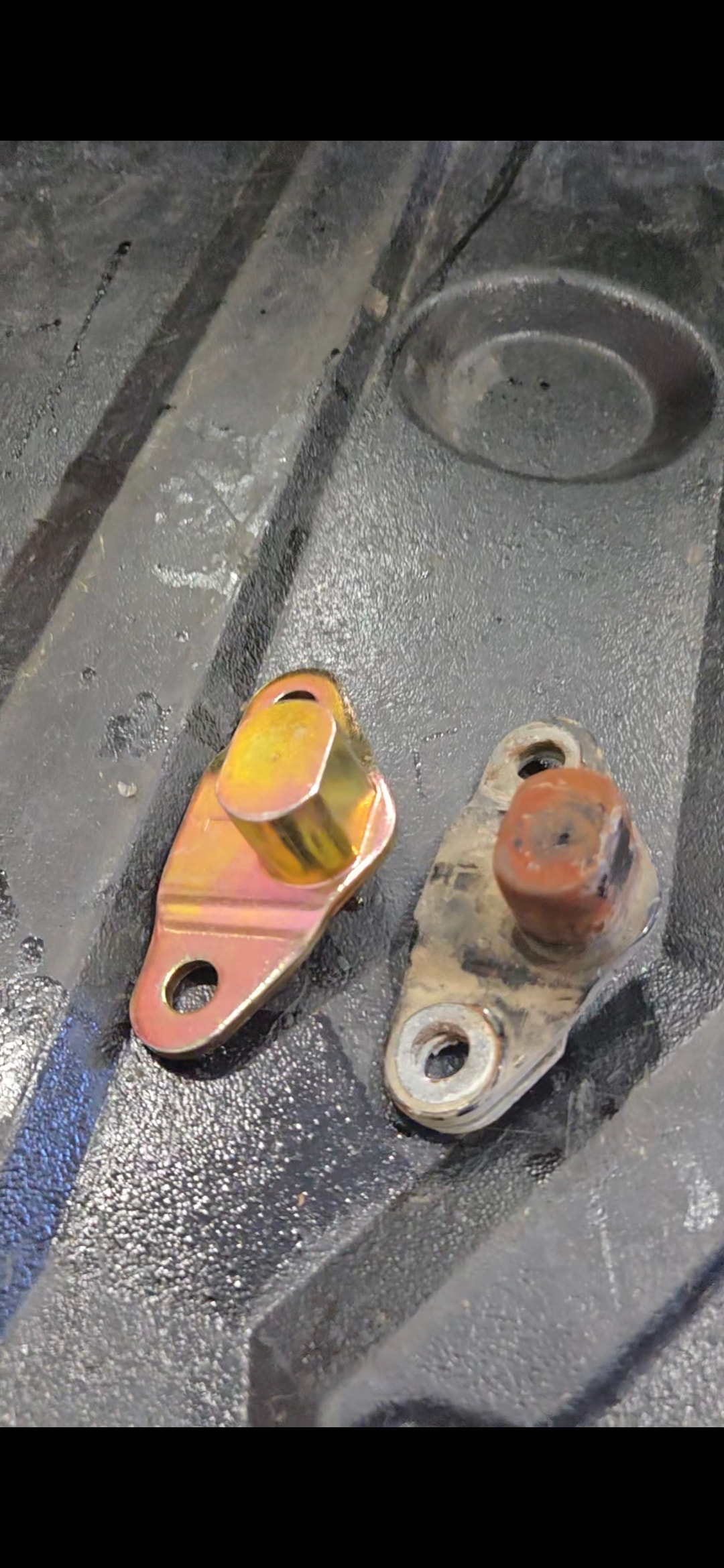

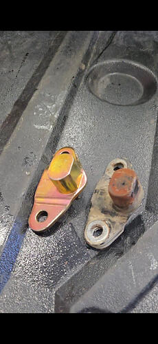

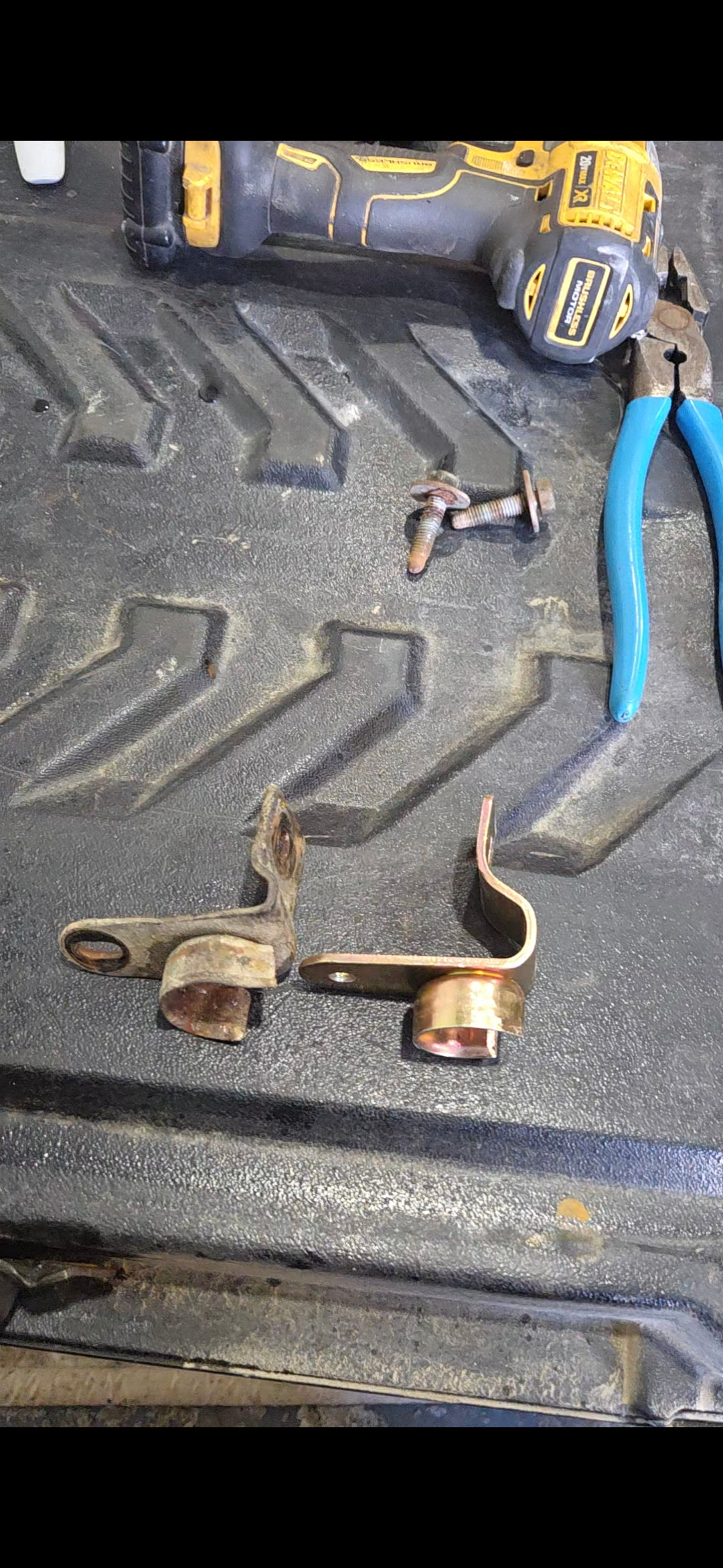

New parts from Dorman worked good - but not so great when it comes to tailgate side.

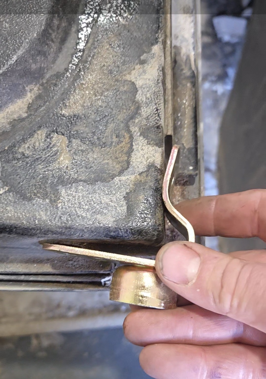

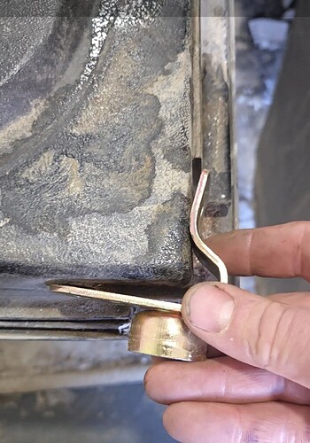

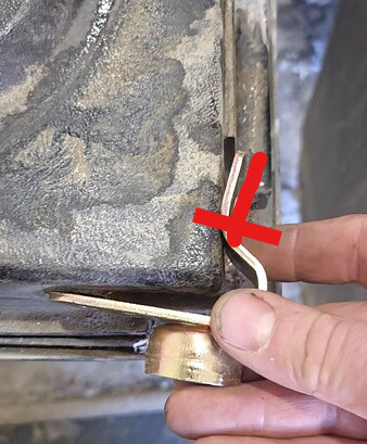

Tailgate side doesn’t fit well at all. Very poor Dorman fitment there! I ended up going with junkyard OEM parts, as my passenger side tailgate mount was cracked.
If you are in a bind, you could drill new holes in the Dorman part. I have also heard of guys “sending it” with the impact to get it to mount and work as well. Totally up to you on which route you want to go with.

I gotta be honest here - I did not thinking rebuilding a GMT800 tailgate with NEW parts would be super hard. Between the Dorman and Amazon kits, it was a bit of a let down and I chose to flatten and drill out the Dorman set.
I flattened out the side closest to bottom of tailgate using a vice, and re-bent it out 1/4" (angled to fit snug against the tailgate). Current dorman part is bent too far in, with holes that don’t match.
The hole I redrilled the hole about 3/8" over to actually line up with the tailgate bolt hole.
Tailgate is now rock solid!
