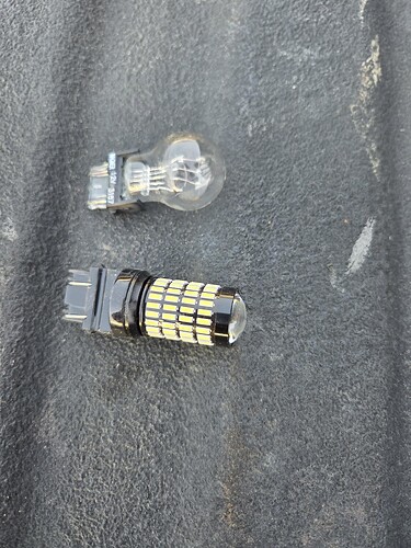

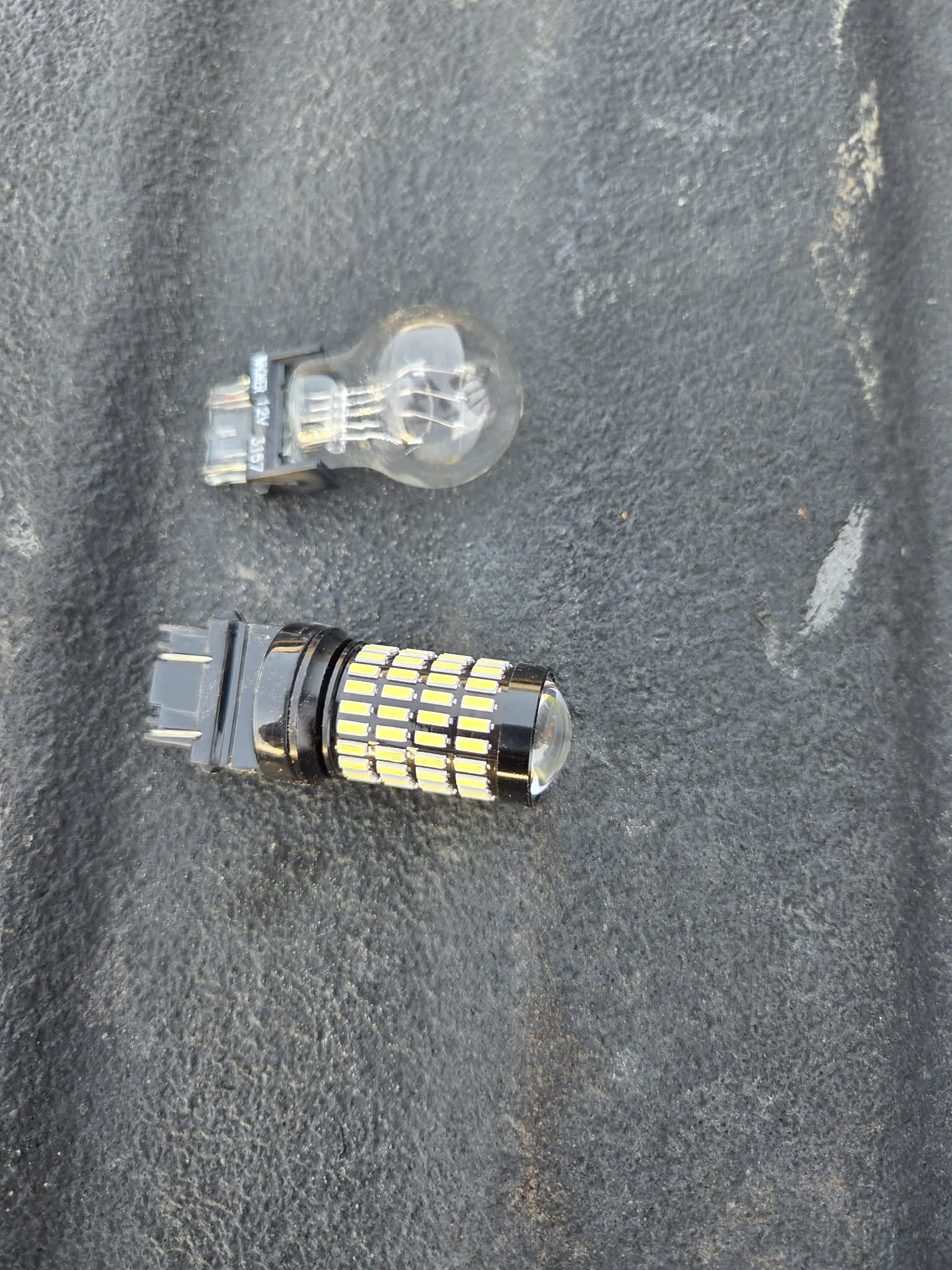

For bulbs, ditch the factory 3157 halogens and switch to LEDs. They draw less power and the light output difference is huge. Aim for something in the 3000–4000 lumen range with a projector-style design so the light actually throws backward instead of just glowing inside the housing when you’re backing up.
I’ve had good luck with Auxito bulbs in the past and have tried a few different styles. They seem to last; I have some still running good after 5 years!
The first style that I’ve had good success with is the non-projector version. Link to the bulbs here.
These bulbs do not have a lense on them, but are still super bright.

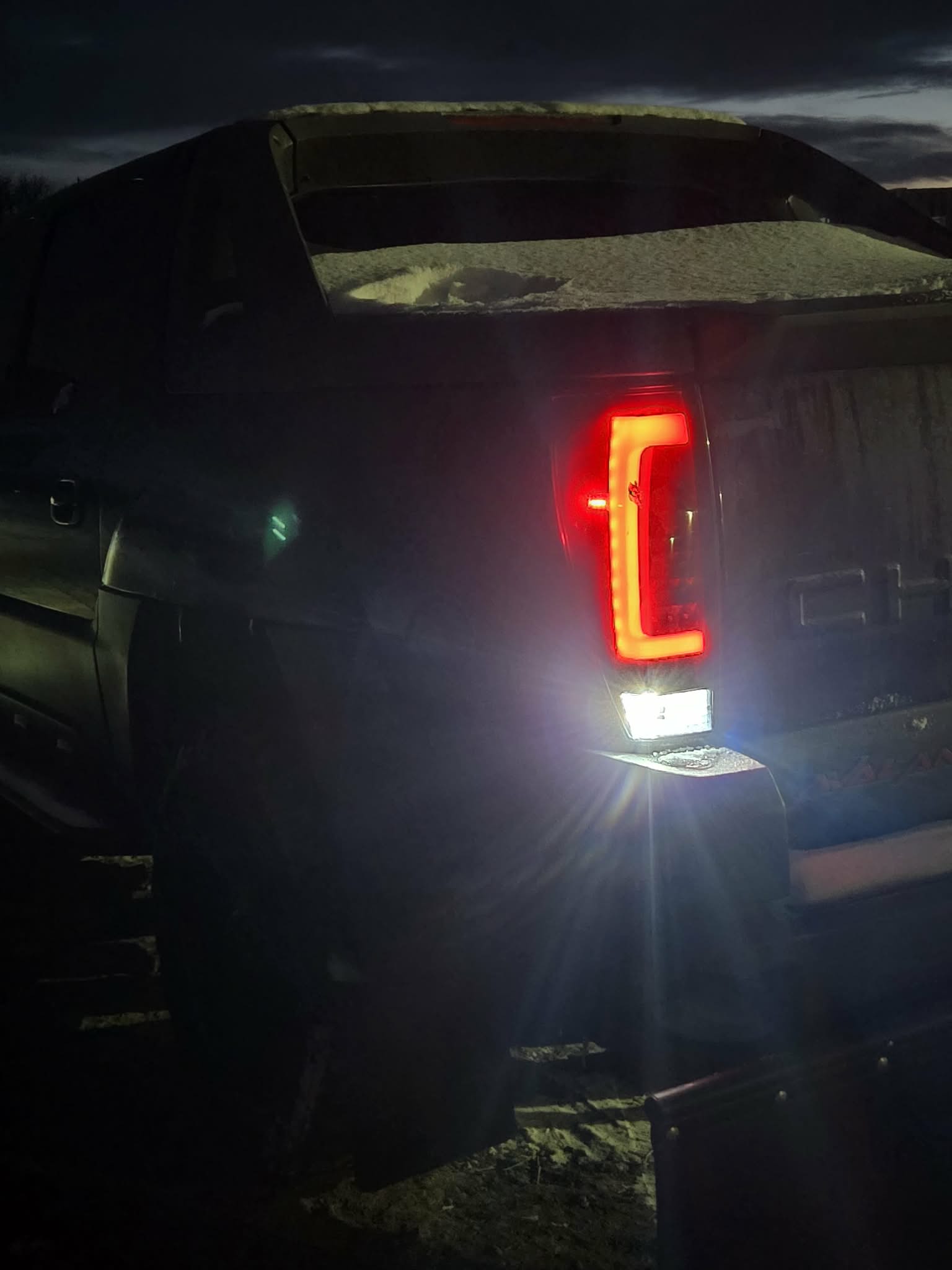

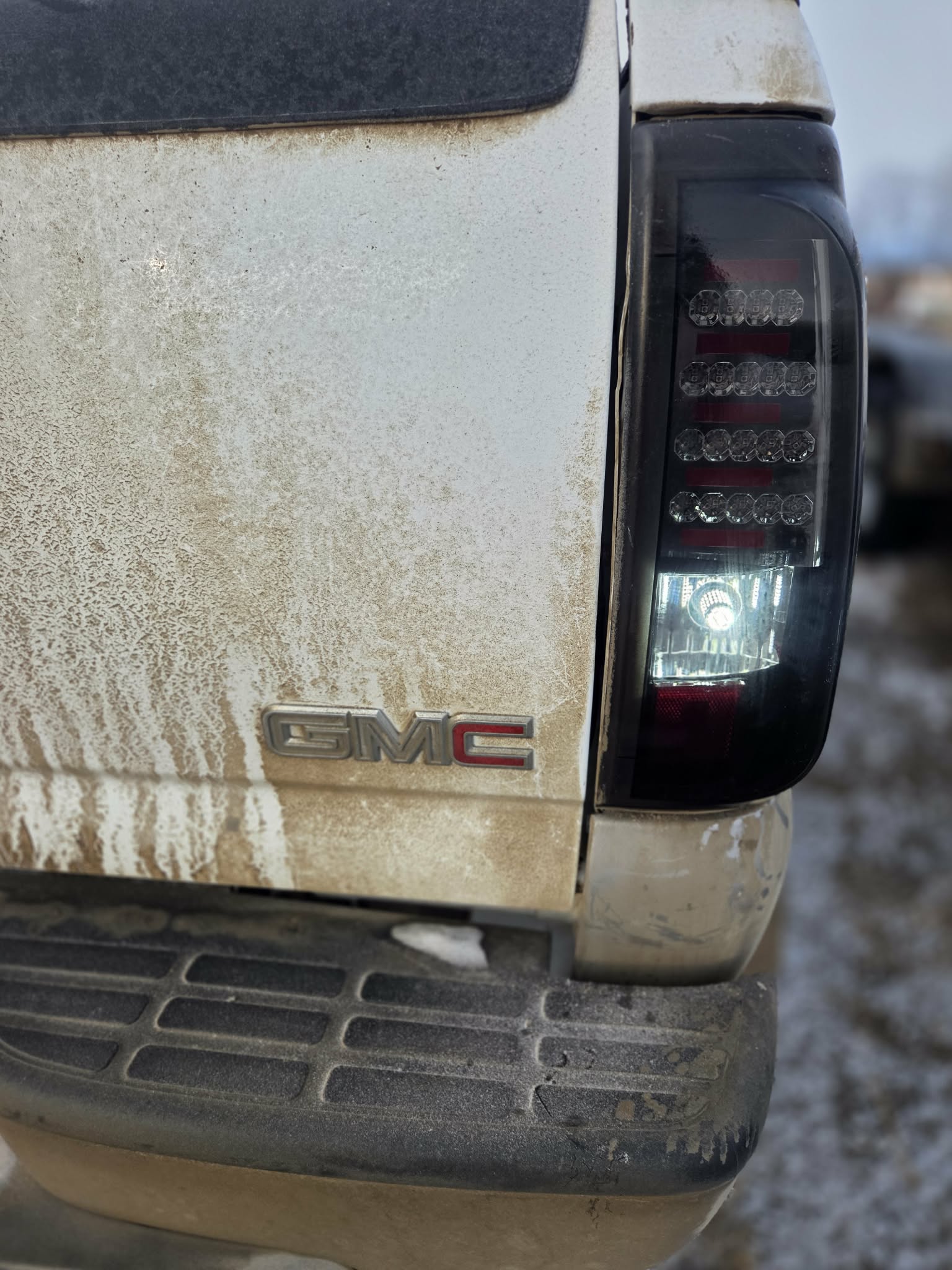

I’ve also had good luck with the “projector” style lens. The clear rounded dome on the tip focuses and throws the light backward instead of letting it scatter inside the taillight housing like a standard LED or halogen. That lens is what gives it the “projector” effect and improves usable light when reversing. If you want the best light output possible from factory taillights; opt for these “projector” style bulbs. Link to the bulbs here.
Even in the daylight these bulbs are super noticeable and impressive!
They are even brighter at night! :grinning_face:

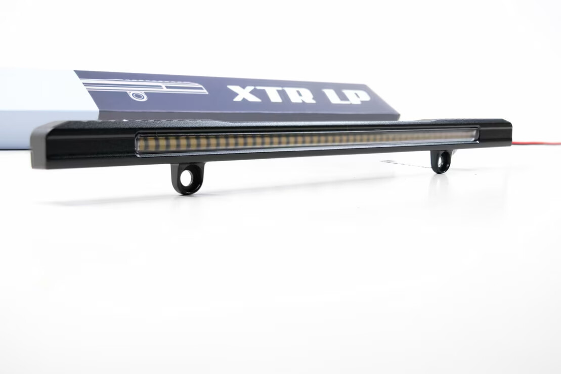

If you want maximum reverse lighting, the XD License Plate Reverse Light Bar is a solid upgrade and can be triggered off the reverse light circuit.
GMT800 trucks run two reverse bulbs. Factory halogens are roughly 21–27 watts per bulb, putting the total load around 42–54 watts. Switching the reverse bulbs to LEDs reduces the draw significantly, leaving plenty of available capacity to trigger and run a license plate reverse light bar properly.
