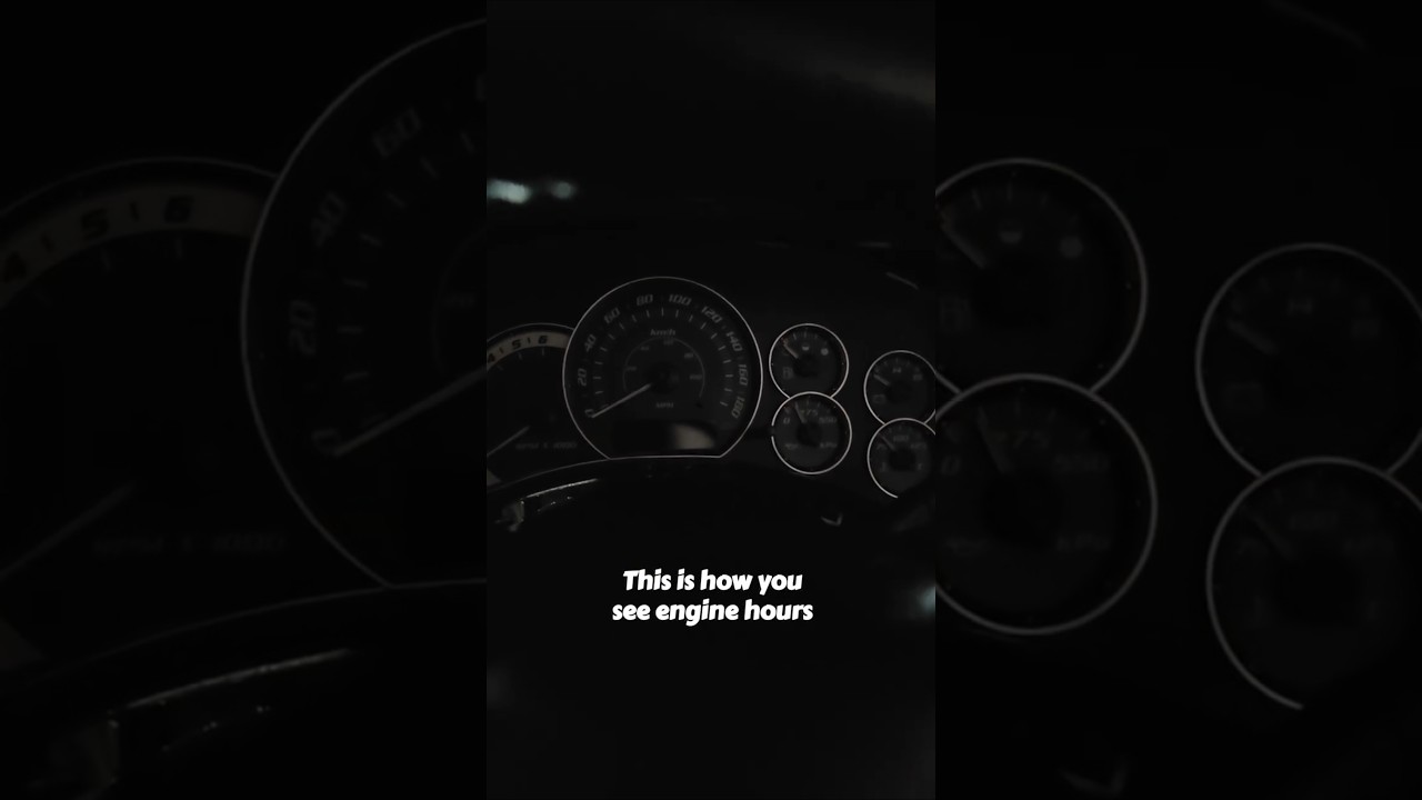

How to access it:
  • Key OFF (engine off or running)
  • Press and release the trip/reset button on the cluster to show the odometer
  • Press and hold the trip/reset for 3 seconds to display engine hours
  • After 3 seconds, there’s a hidden sequence that will show total engine hours
It’s not documented clearly, and most guys miss it completely (we hope this post will change that)
WATCH BELOW:

If you take the mileage/hours you will get the average speed driven. From the video: 201,777 KM and 4,874.9 engine hours. This equates to an average speed of 41.39 KM/h or 25 mph.
