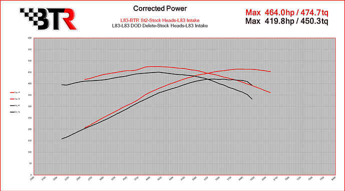

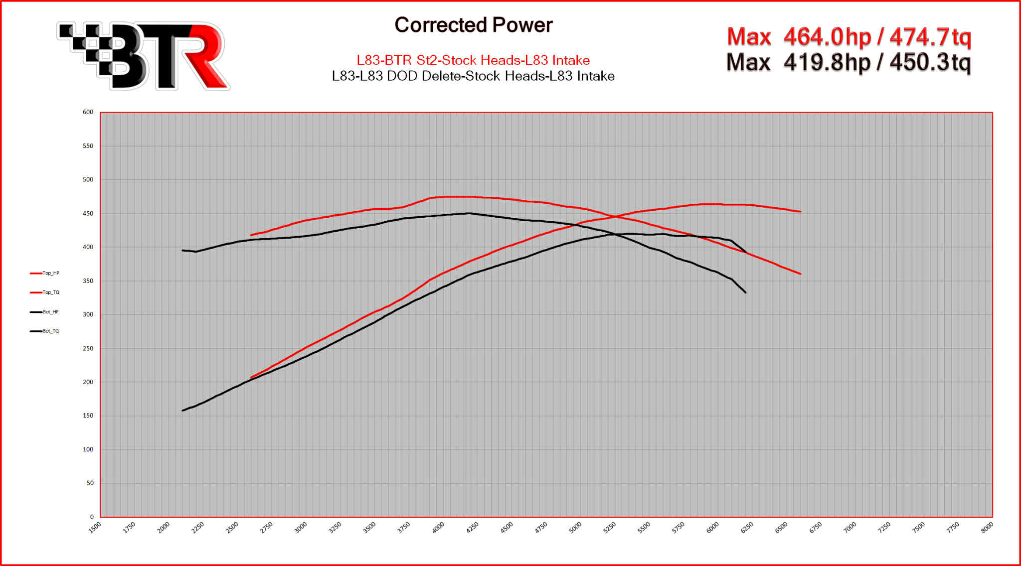

A BTR Stage 2 cam was installed, with new .550 lift springs to accommodate the cam.
Player3 Performance tuned the truck, and I must say it is rowdy and finally reliable now!!
Being its a daily driver/occasional tow rig - I didn’t want to go higher than the Stage 2 cam. It’s on the list to put a converter in it, but for now I am just rocking the stock converter. You feel it occasionally at lights. You get used to it. Eventually I’ll throw a converter in it, and possibly some trans work. For now, I’ll just keep the 6L80 cool and plan to not tow over 6-8k.
We swapped the mufflers to MagnaFlow Magnapacks (video below of a cold start). Still some slight tuning issues as the Misfire monitor has to go up a little to avoid an infrequent CEL due to the cam @ idle but overall very happy so far!! I’ll need to throw an X-pipe in as well to equalize both banks.
Overall drivability is like night and day. I have put about 10,000KM on this setup now and it feels like day and night. Before, the stock LC9 felt gutless. Mostly tuning I am sure, however there didn’t seem to be much of a midrange. The pedal felt dead, and the very lack of mid-range isn’t what you want for a pickup truck.
I often tow a bit and haul trailers/material with the truck. Before, it felt like you had to pin the thing to go anywhere, or to pick up speed. Now, with the BTR Stage 2 and tune, it feels great throughout the mid-range.
