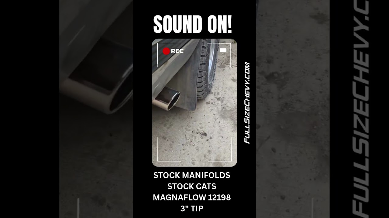

My favorite of this bunch for a daily driver would be the 14” Magnaflow 12198 (setup dual in/single out using factory pipes and catalytic converter)
