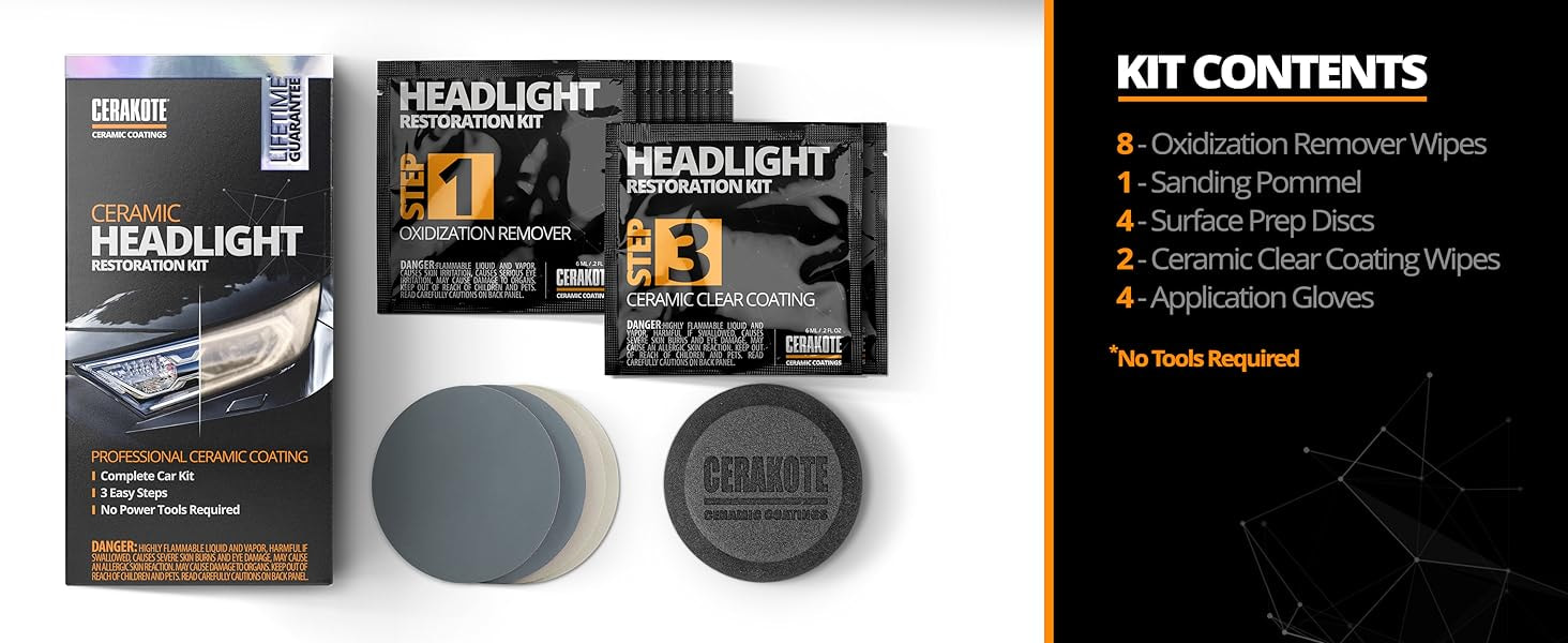

Fix the darn housings first, this is where people mess it up.
If your lenses are yellow and sandblasted, no LED is going to fix that.
You’ve got a few options that don’t suck, listed from cheapest to most expensive:
- Cerakote Headlight Restoration Kit - this is a great kit for restoring headlights.
- Used Marketplace replacements; in case you have broken mounts or aiming issues
- TYC / Depo stock-style replacements – clear, cheap, plug-and-play
- GM OEM if you feel like spending more (not “budget” but they fit right)
Don’t waste money on bulbs until you can actually see through the plastic!
