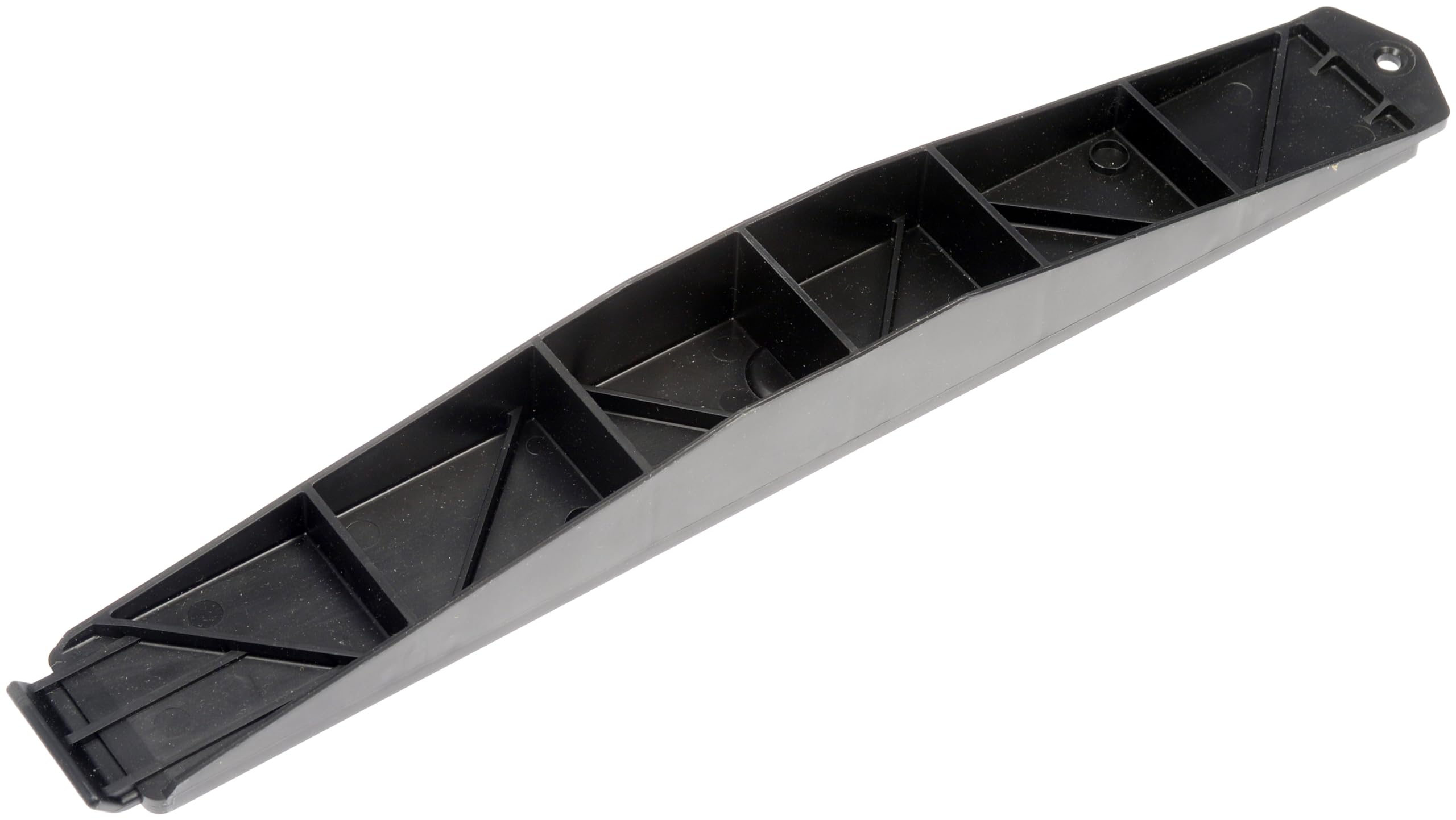

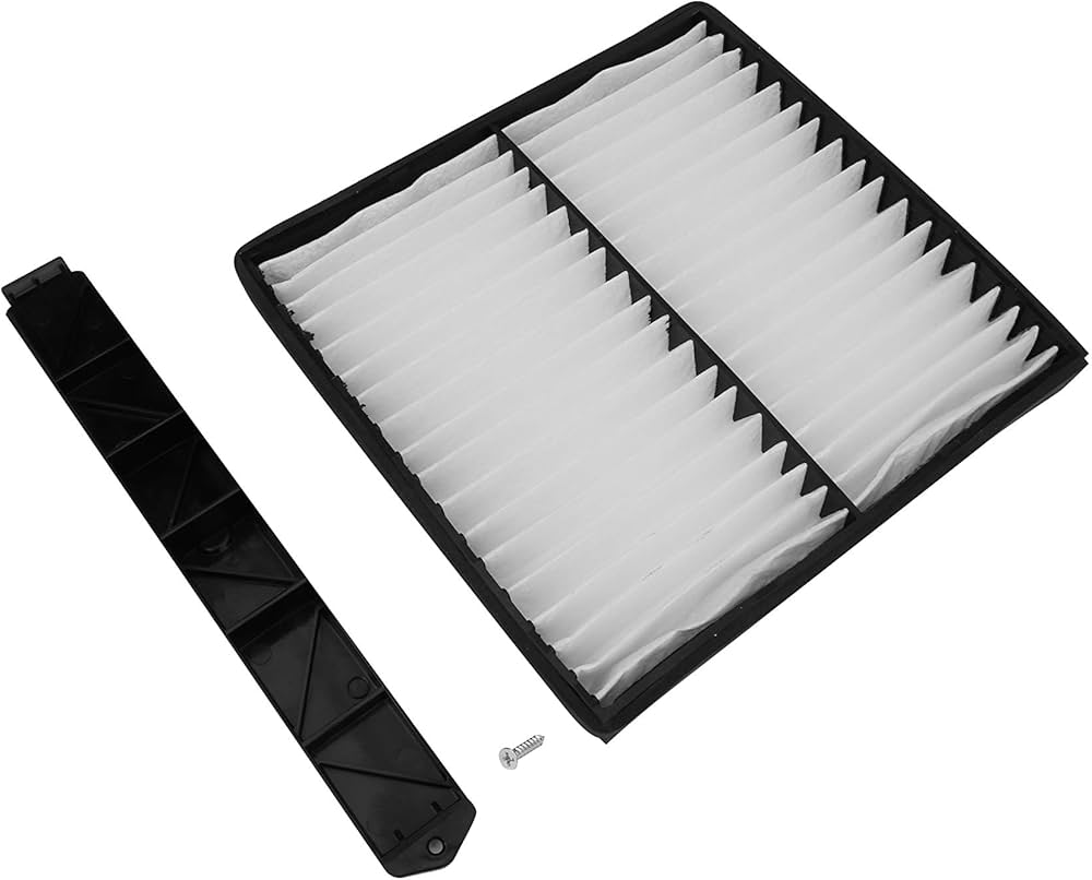

  • Cabin air filter retrofit kit (filter + access door)

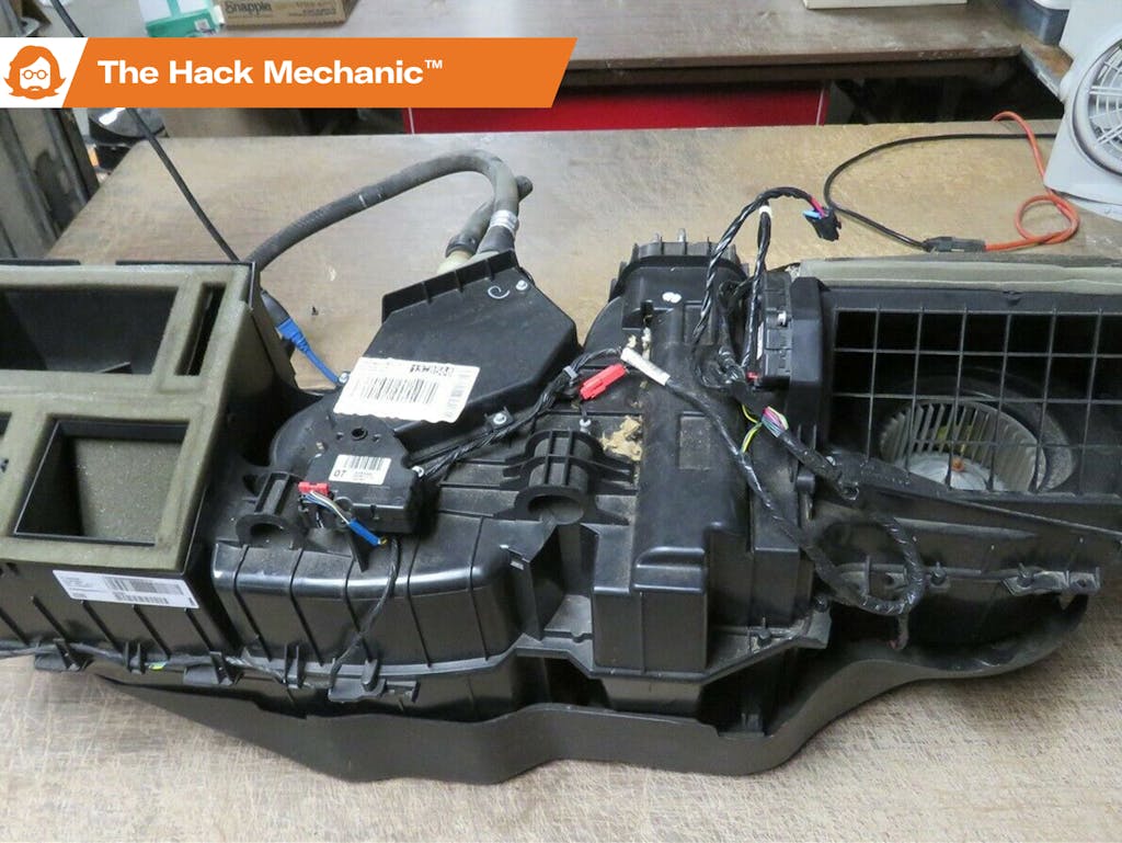

The access panel is behind the passenger side lower dash, directly under the glove box area.
If you remove the hush panel, you’ll see a rectangular outline molded into the HVAC housing. That’s where the filter was intended to go.

2. Locate the Molded Filter Outline
You’ll see a rectangular cutout stamped into the plastic housing. GM left the guide in place — it just needs to be opened.
3. Cut the Opening
Using a utility knife or rotary tool, carefully cut along the molded outline.
Take your time. Avoid cutting too deep into the evaporator core behind it.

4. Insert the Cabin Filter
Slide the filter into the housing with the airflow arrow pointing downward (toward the blower motor).
Make sure it seats fully.
5. Install the Cover Door
Attach the retrofit door using the provided screws. This seals the housing and allows future filter changes in minutes.
