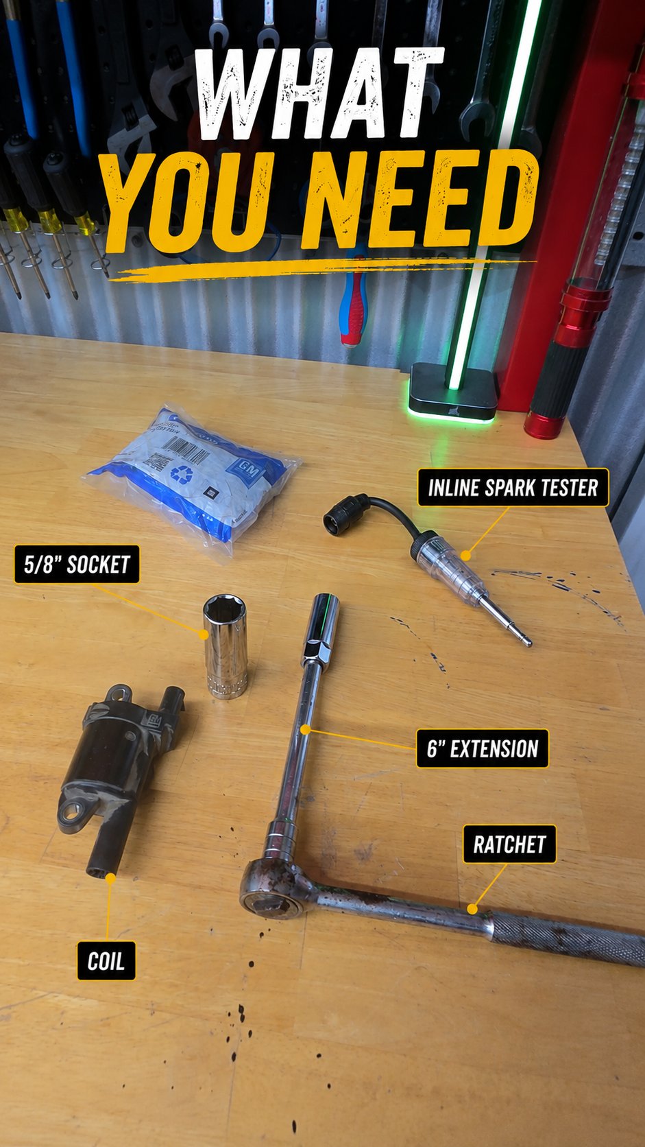

What you need
Nothing exotic — a scan tool, an inline spark tester, a 5/8" spark plug socket, an extension and a ratchet, plus a known-good coil to swap.

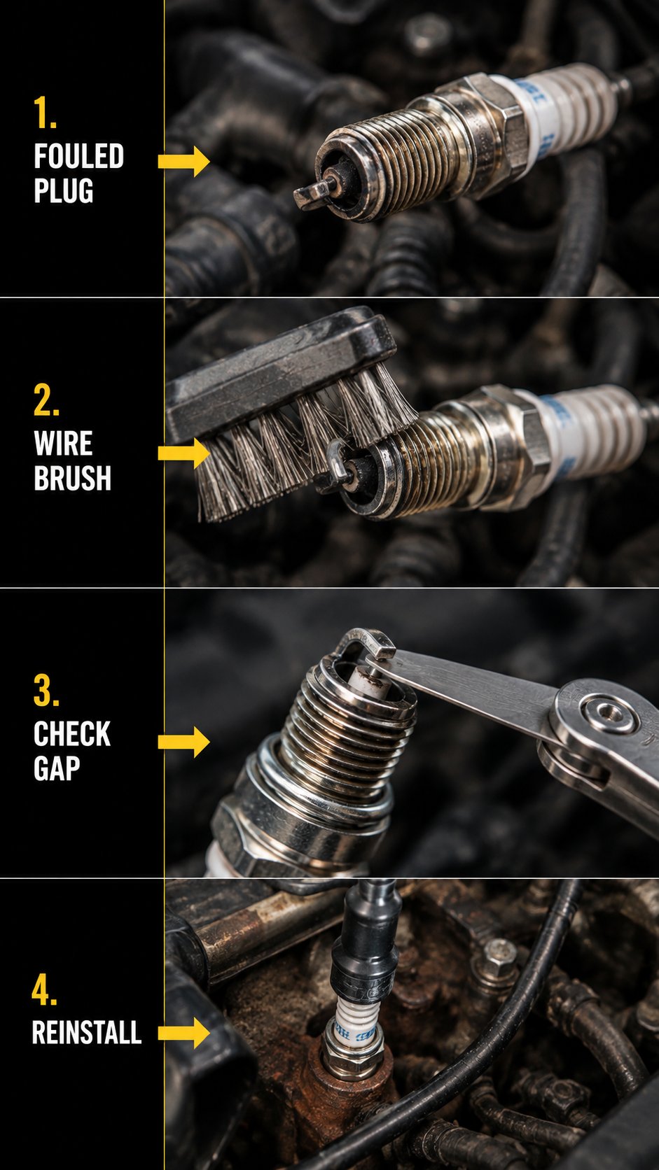

Step 2 — Inspect the spark plug
Pull the plug on the dead cylinder and read it. A fouled, oil- or fuel-soaked, or worn plug can cause the miss on its own. Clean it up, check the gap, and reinstall — or replace it if it’s done.

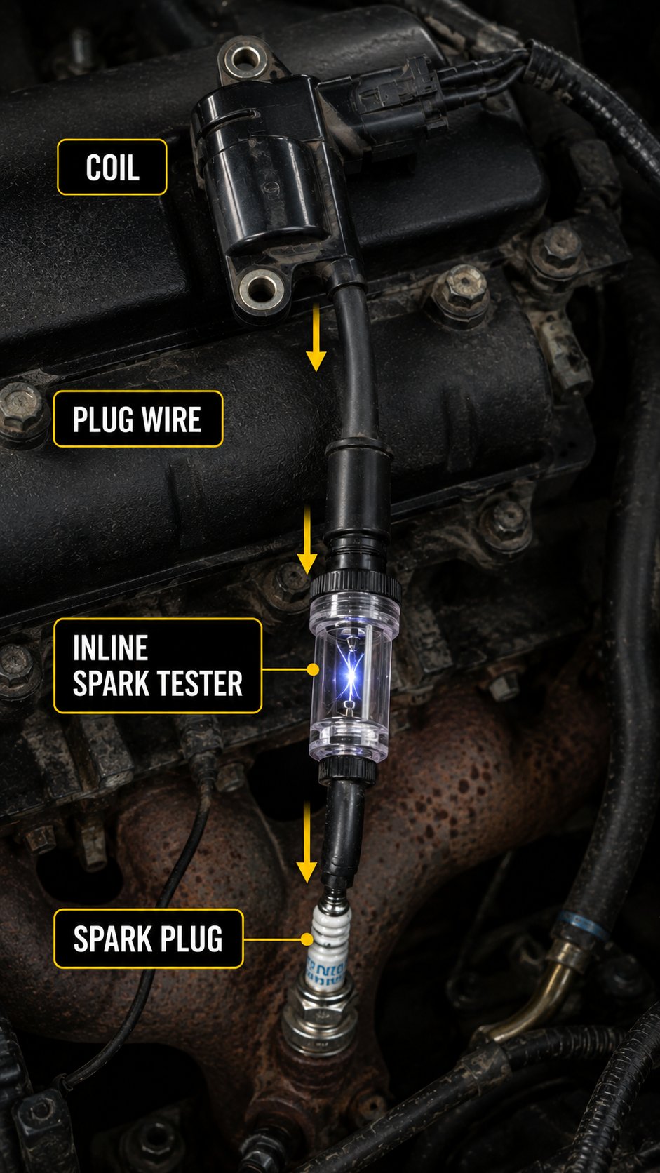

Step 3 — Check for spark
Put an inline spark tester between the coil/plug wire and the plug and crank it. You want a strong, consistent blue spark. Weak, intermittent, or no spark tells you the problem is upstream of the plug — the wire or the coil.
Step 4 — Test the wire, then swap the coil
Check the plug wire (or boot) for cracks, carbon tracking and resistance. If the wire is good and spark is still weak/absent, swap the coil with a known-good one from another cylinder and re-scan. If the misfire follows the coil to the new cylinder, you’ve found it. That’s exactly what happened here — the coil was the failed part.

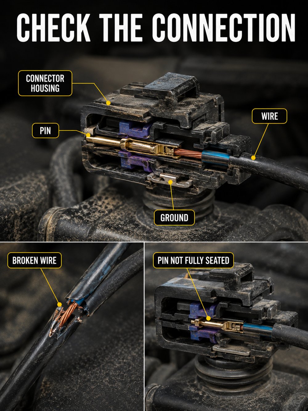

Step 5 — Don’t skip the connector and wiring

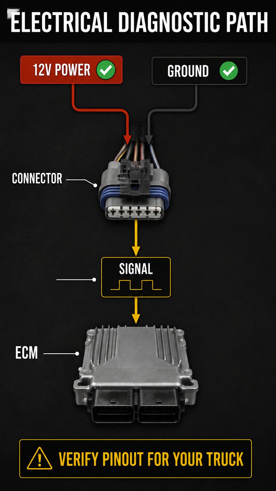

Before you call the coil bad, rule out the connection. A backed-out pin, a corroded terminal, or a broken wire under the insulation will mimic a dead coil.
Each coil connector has 12V power, a ground, and a signal (trigger) wire from the ECM. Confirm power and ground are present and the signal is reaching the connector before condemning the coil. Pinout varies — verify yours for your specific truck.
