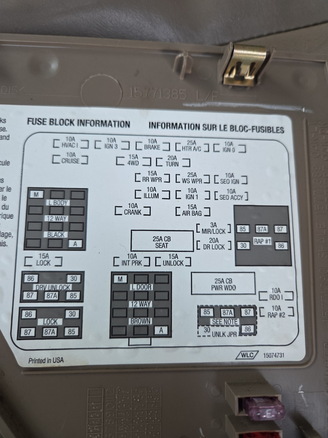

Does this sound like a blend door issue? I crossed my fingers and tried the car off-pull HVAC fuse for 10 seconds-car on- don’t touch anything for 40 seconds relearn but it had no affect. When I adjust each of the driver’s and passenger’s heat/cool slider it goes from really hot to meh cool and I don’t hear any clicking or anything from the footwell/under dash area.
Still nice to have the rear AC vent turned around and pointing down my neck when I drive!

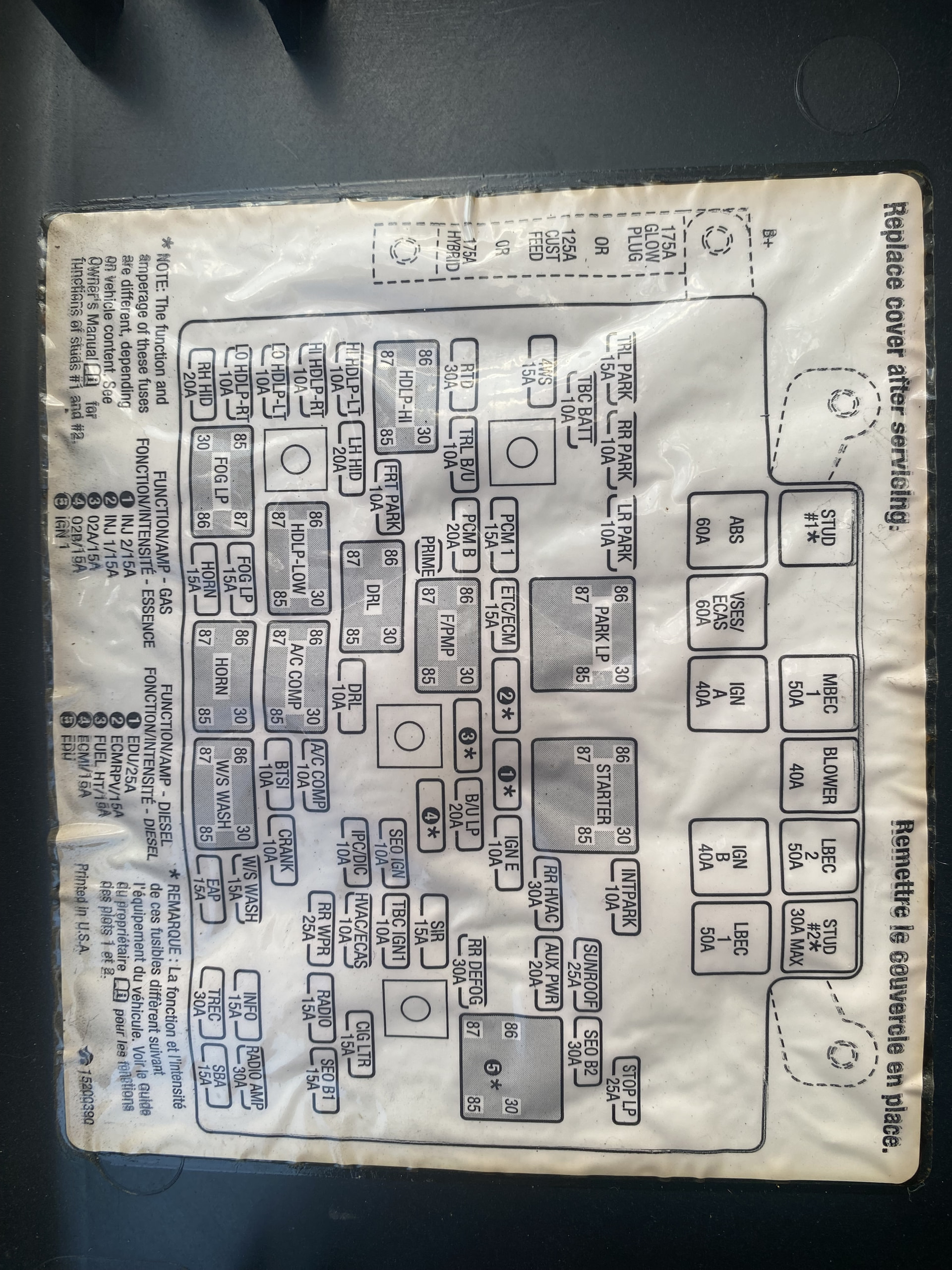

Is the HVAC/ECAS the right fuse to pull for the relearn procedure? I don’t see one that says HVAC/BATT

You can try the relearn, it won’t hurt anything. Yes pull the HVAC/ECAS Fuse, I had similar issue on my 02 8.1L after I got it running a few years ago. My complaint was AUTO mode sometimes worked, sometimes did not. I did disconnect the battery for 30+ minutes as well for a bit to try to see if that fixed it but it did not. I ended up replacing the cabin air temp sensor (just above your head when driving) and did this relearn on the '02:
Key OFF
  1. Pull HVAC/IGN fuse (or HVAC B fuse)
    – Driver-side dash fuse panel. Mine was labelled HVAC 1 and HTR A/C on a 99-02. Yours is 03-06, looks like it is labelled HVAC/ECAS. Either way, pull it and continue on below.
